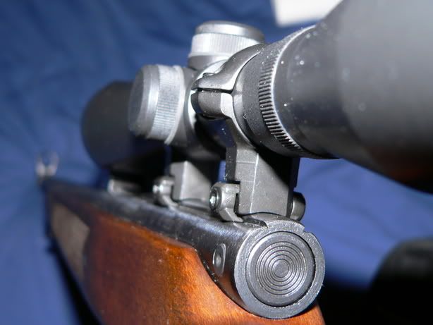

Np K98, What worries me is that the rail on the Toz-78/99 is slightly arched. These rings that you want to buy appear to have a flat base. I will buy those Illingworth rings for my LOS-7 rifle. It has a flat rail.
Here is a pic of the mounts on my Toz-99 to give you an idea.
Why thank you very much Speckfire! That sure is a good picture you posted, and now I can see exactly what you mean. :D
