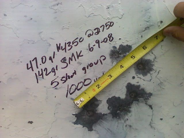

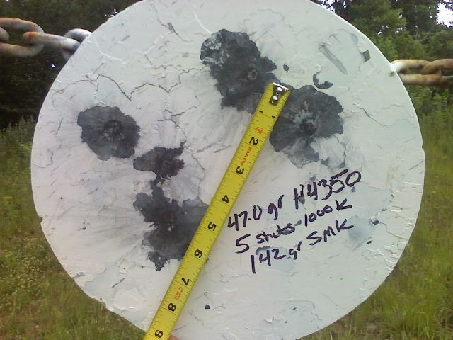

If the distance is 300 yards or less, I would use paper targets and stands as you can still see your hits at that distance with a decent power scope or spotting scope.
Beyond that, I would mostly use steel gongs like the ones we use at out local range:
The advantage to these is that you can see and hear your hits even out to 1000 yards (or more) through your scope, without the need for a spotter or someone manning the target. And the hits are clean enough that they can be measured if you wish.
All that you need to do to maintain them is drive down range and re-paint them when needed. You can also put a target stand next to each one, at each distance and just use them to ensure that you're on target before printing a group. They're really handy, if I had land that is the way I would go for targets.

Thanks Kombayotch - those gongs sound pretty cool - where do you get something like that? (And those are nice looking groups at 1000 yards).
