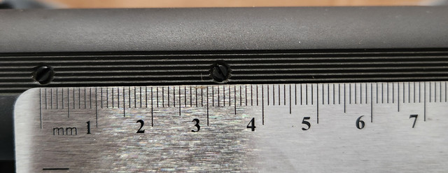

I measured it up.
Center to center of first set of holes (closest to reciever) is 25mm.
Center to center from middle to farthest hole( closest to muzzle) is 32mm
OAL center to center is 57mm.
I test fit a Marlin 336 rail I have, off by ½mm
Ordered from Magwedge.
I was tempted to fit the Marlin 336 rail but don't have any 6-48 screws.

Hopefully the two holes on the rail end up lining up, it won’t be hard to drill a corresponding hole though. The magwedge rail has a channel you can use as a back up rear sight notch.
