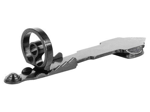

Here's what i like on my Winchester M1892:

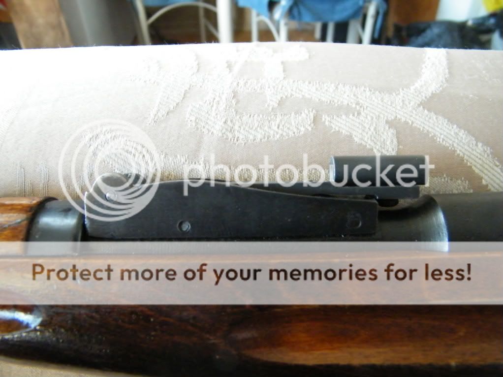

Picture as promised
here is my peep mounted on the rifle. It simply replaces the rear sight with no modification of the mosin.
That's essentially a home made "Mojo" rear sight. I'd greatly reduce the length of the tube (to about 1/4"), as any change slight in elevation will obscure the front sight.
Andy I think you are right
The mojo sight is what i based this off of. In my defence, I did try to buy a mojo but no one will sell me one here in Canada. I am going to wait untill I sight the rifle in to modify the sight as you suggested. I am inexperienced with building sights do you have any other suggestions? I appreciate your input and help so far. Thanks
I think you did a great job - no-one was criticizing, just offering ideas for improvement.
I might have a Mosin Mojo Sight for sale - I'll look for it over the next few days. ;)
To be really effective, the peep sight should be situated near the shooter's eye and be of smaller diameter. This has the double benefit of lengthening the actual sight base and giving you an increase in depth of focus by the iris effect.
A smaller peep is naturally auto-centering. You don't have to worry about your rear sight, just get the front sight post on target, focus on the post and squeeze. That's what makes No.4MkI Enfields so effective.
A middle barrel "peep" is a joke. You can see that on some Arisakas, they just make it difficult to see the target.
PP.
Andy has a point, as the sight is raised up for longer range shots the hole down the tube will be out of alignment and your "view" will go from a circle to more of a football shape.
I guess we don't know what you may have done to avoid the issue but a way to prevent the occlusion that would occur with a change in angle would be to drill your small original hole through the rod and then drill a second bigger hole that is just a little smaller than the OD almost all the way through so there is only about 1/32 inch of the small hole left. On top of this if you were to drill the rear with a centering drill it would aid in avoiding the sun from over your shoulder from glaring on the rear face.
