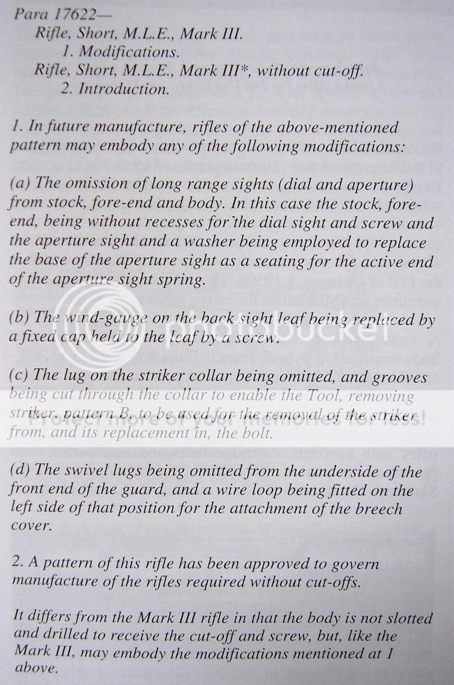

The cutoff wasn't deleted in 1916, it was omitted from the MkIII* that was introduced in 1916 so after that date there were two models of the SMLE, the MkIII & the MkIII*, at least Lithgow & LSA produced MkIIIs into 1918.
The cutoff was omitted from all production in 1941 & of course there were thousands of rifles in service & at war that had the cutoff fitted & i would doubt very much they would have been withdrawn so the cutoff could be removed & if they had been removed on mass the cutoff plate would be a very scarce item, which it is not.
As for the saying "reintroduced after WW1" while this is not incorrect, it is misleading.
