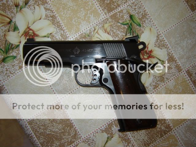

What sights on your Norc 1911-A1?
i saw one of them at a gun show the other day, and I thought they were ok for military sights. Low profile, but pretty sharp and with the 3-dots. Yours the same? This was one of the unmarked 1911A1 guns too so I assume so.
I thought that Norc sights were not a common cut type? If you wanted better sights you had to have the slide cut to fit standard types? No?
Rear is a standard Colt dovetail.
Front is standard narrow tenon Colt.
Or you can cut a front dovetail.
The govt model 1911-a1 non-Norc marked guns have a standard narrow tenon front and a standard 0.344x65degree rear GI dovetail
I used an MGW front ($10) and a 10-8 rear ($30). Both fit with minimal fitting.
