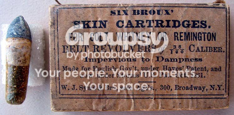

This .36 Cal. cartridge does not belong to me---but it gives you a sense of what they look like.
This is the only packet of .36 cal. cartridges that I own----also shown, 58 cal and .577 cal paper cartridges.
