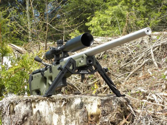

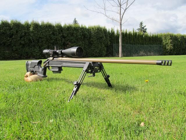

Consider the MPOD as well if looking for a dead stable range bipod. Will fit on any Anschutz sized rail and very easy to learn to use.
preload not necessary and rock solid. Well priced too.
