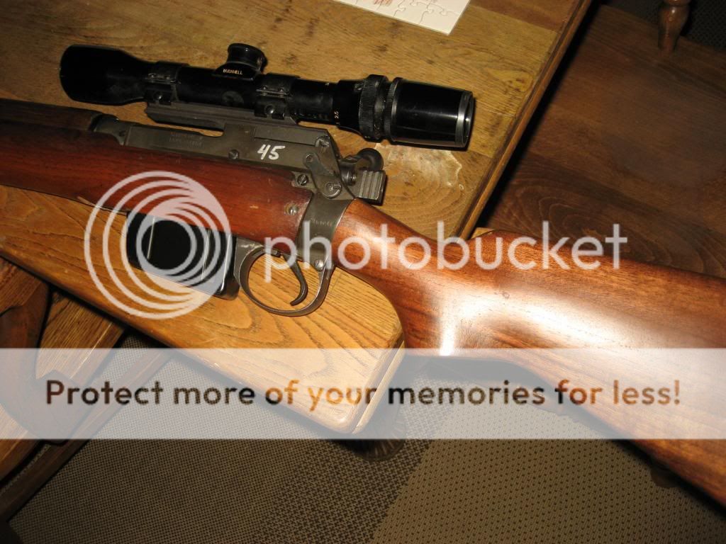

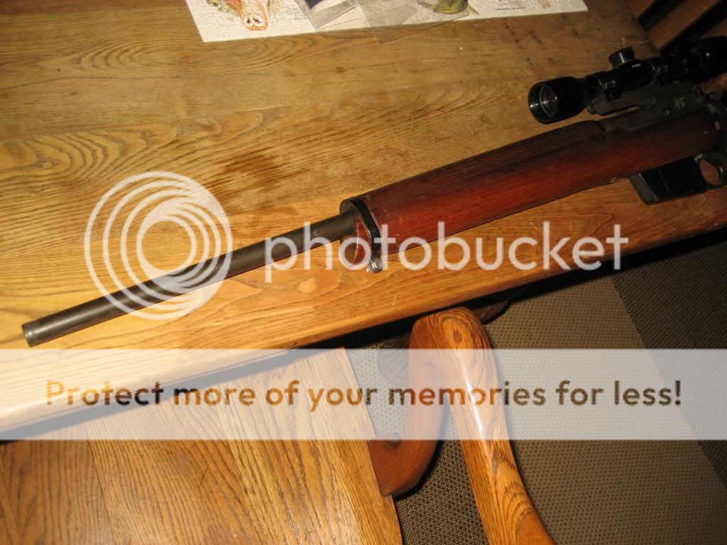

I was thinking of cutting the barrel off at about 20" and putting wood on something like a #5 carbine. I made a similar carbine for my son, using a cut off LongBranch barrel. It has a Monte Carlo butt on it which lines up nicely with the scope. It is quite accurate, and accurate guns intrigue me.
I once made a 20" hunting rifle using an old target rifle barrel. It is not too heavy, carries well and is a good shooter. This barrel on the #4 is a bit lighter than that, so should work. I would have to ream out the barrel channel a bit in the wood, but that is easy. I would start off with a floated barrel.

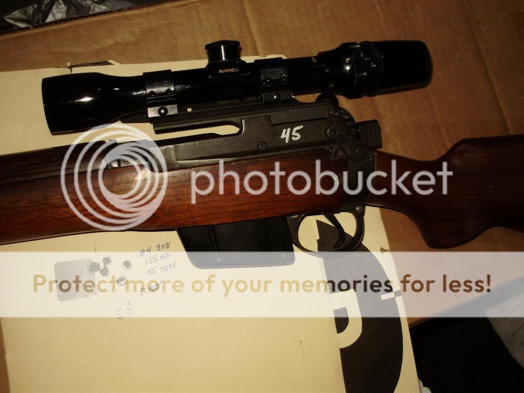

Just found this picture. I shot some 308 target ammo in it and got a good group. If a milsurp can tell the difference between good ammo and mediocre ammo, it is a good rifle. This one has a cut down (21") DCRA barrel. My barreled action has a heavier target rifle barrel. So might do even better.
I would definitely make a neat little scout rifle out of it. However I would keep the barrel around 22 inches. Post some pics when you get a chance.

If it shoots that good, why change anything?
