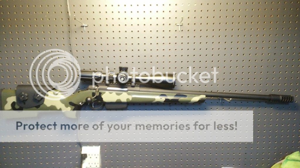

For what its worth I went with a Tikka T3 SS Varmint in 7mm RM and love it. I put
It it in a Boyds tactical stock and attached an adjustable cheek piece. Metal bolt shroud and
Swept bolt handle. I also use a tactical scope so overall weight is not on the light side but I'm used to
Carrying heavier rifles so it doesn't bother me. It also has a muzzle brake and just absolutely shoots!
Last year before hunting season and after .5 moa results at the range I tested it out to just shy of 600yrds
And it was still at .5moa as groups were 3". I was using 168g Berger VLD bullets. First trip out with I managed
To drop a real nice 5 point whitetail. Only about 135 yards but standing unsupported and didn't even feel the weight when your focussing
On other things lol. Next I'm going to try some new 162g ELD X bullets and see how they work.
Good luck
my choice went on the 300 WM but built on a tac300 action and 28'' pipe.
200 nosler accubound are extremely effective on moose and for the scope I use a weaver tactical 3-15(FFP, illum. and locking turrets)
I like the sounds of your rifle, I think for sure I'm going the T3 300Win varmint route but I'm thinking about if I want it in a chassis or stock.
Could you send me a photo of your 7mm in the Boyd's? I'd like to see how it looks.
