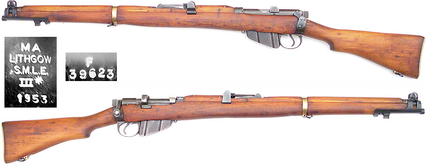

A google for "coachwood" was useless. Too many retirement communities with that name.... :D I tried "australian coach wood" just now and at least got a Wiki hit that made sense. But no pictures of what the wood looks like other than that its other name is "scented satinwood".
Hold on, I tried adding "images" and got this;
It's hard to say if this is the wood simply oil finished. But if it is then I think there's a few different options that would look very close when oiled. Beech or birch come to mind. Beech would have more of the speckled grain look but birch when oiled and after some exposure to the sun should honey up to a color very close to the picture.
If you wanted to speed things up birch with some tan to light brown leather dye as a "stain" to simulate a year of sunshine on the wood should provide a pretty close match.
Is it me or are the rear sight guard ears backwards on that SMLE ?
That production date is late too, must have been one of the last ones off the Lithgow line.
Not too worried about that. It's just a picture that came up from the search. The key issue is if it looks like the same sort of coach wood that the OP's rifle looks like.
