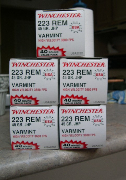

I've got two Remington rifles in .223 with 1-12 twist barrels. Both like to print raggedy hole grips with that econo Winchester whitebox 45 gr HP .223 ammo... :eek: Your SPS should be able to do the same, or better....;)
