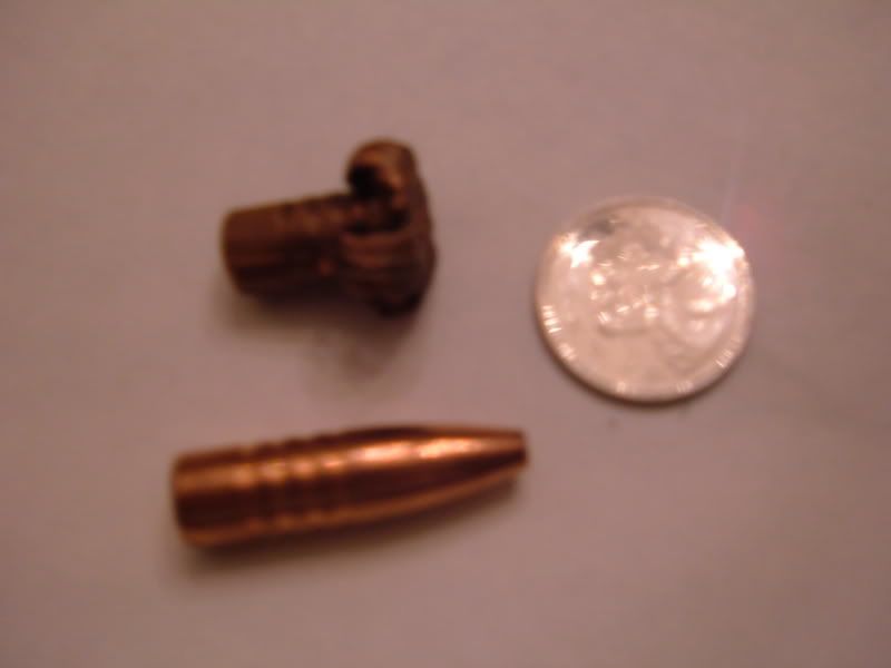

Do you want the moderate load to reduce recoil or lower the meat damage? If the second is the case don't worry about it, you won't be shooting any moose in half with a .375 H&H. Just load up some 270 TSX bullets and live happily ever after.:D My muzzle-loader does more meat damage than that combination, and that was on animals from 150-1000 pounds. My current load is 77 grains of H414 and the bullet seated 30 thou off the lands.It isn't max. Recoil isn't a whole lot more than .300 Win Mag, but the rifle is a couple pounds heavier too.
I've posted this picture before, but it is the exit hole on a zebra shot square through both shoulders with that load. Impala look the same, dead but not mangled. I also included the only 270 grain TSX I ever recovered, picked out of a gemsbuck shot more or less lengthwise. It penetrated 4 feet, expanded 100%and lost next to nothing in weight.
