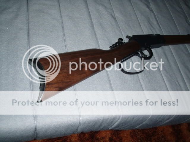

I purchased a crescent butt plate from Bownells, a raw casting.
Ground off the ridges and casting ear, sanded it smooth and then to a final, mirror like, polish. Then I used an acetylene torch to heat it up and give it some nice colors before dunking it in oil (canola oil was on hand) to preserve it from rusting.
The fitting it to the butt stock was a harder job, (I work with metal, very little experience with wood).
Makes my Henry 22 seem more period correct.
For a guy that doesn't work wood much that came out looking fantastic. Of course we're often our own worst critics... :D
The only issue with fitting a crescent plate to an existing rifle is that the stock needs to have the "C" cut from it. And that means it ends up being shortened a little in the middle so the points fit the new plate. But this makes the LOP shorter when to use it on the upper arm instead of in the cradle of the shoulder we actually want it a hair longer than the stock shotgun style.
Of course on a custom stock that's not a big deal to do since it can be allowed for. But it's generally not a great idea to put one onto an existing shotgun style stock for this shortening reason.

Yes I found that the stock was certainly much shorter than it was with the flat butt plate.
It is definitely a "Youth" model now. But I am small framed (just over 5'6") so it works for me.
