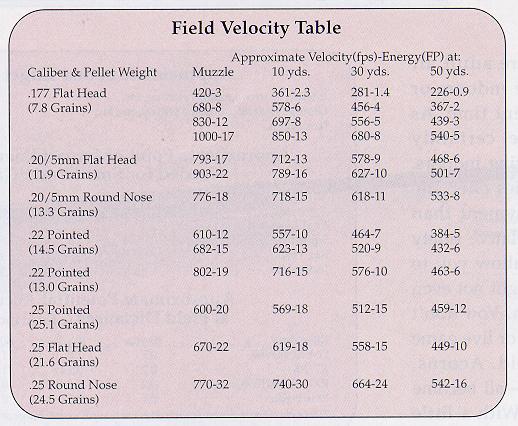

Basically any airgun that shoots over 500 fps is considered a firearm and you need a PAL to own one. That being said, you need at least 515 fps with 5 ft/lbs to humanely kill a rabbit with a .177 calibre pellet gun. For a .22 pellet gun it's 380 fps with the same 5 ft/lbs or energy. For a jack rabbit you'd need 8 ft/lbs or more with a velocity of 670 fps for a .177 and 490 fps for a .22
But, as we all know muzzle velocity is not the velocity that your pellet will actually strike your target with, so here is a table demonstrating the loss of speed/energy at known distances
Basically a good airgun for taking rabbits at ~30m will have a muzzle velocity of 830 fps or greater with a .177 calibre pellet. There are many airguns that are capible of doing that, but you can't get them at Canadian Tire or something, all theirs shoot below 500 fps because you need a PAL.
