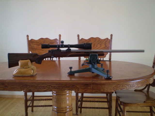

My BRNO # 4 with 26 inch barrel. It is very accurate and gave nothing up to the Anchutz I used when I shot prone 22lr. I took the peeps off and it now has a 5-15 Bushnell 3200...it's now my 200 yard rig (I've since got the proper bi-pod for it - and yes that is a level resting on top of the elevation knob):D
6 inch frying pan at 200 yards...I know I can get better groups out of it. This pic was my first time out with it and I'm still trying to learn the mysteries of the wind.:)
