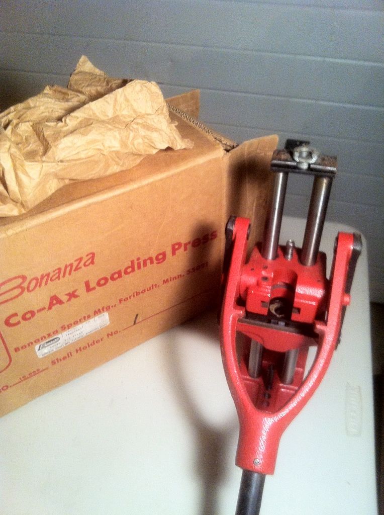

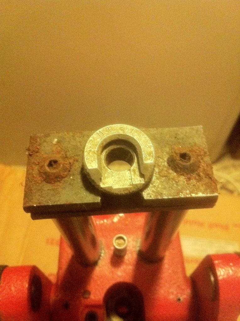

Several years ago a family friend was cleaning out her garage as she was planning on moving and selling her house. Her husband had passed away 25 years or so before but had some of his reloading equipment she needed to get rid of. I believe he passed away before he could use the press as everything was still neatly arranged in the box. Knowing my dad and I hunted she gave a couple of small boxes to us. One box contained a press and the other was a box of brass. We threw the boxes up onto a garage shelf (wasn't a reloader at the time so didn't know any better) where the boxes sat for another 5+ years. After which I decided I wanted to get into reloading and was going to buy a press and did a fair amount of research on various presses when I remembered there was one tucked away in the garage.
Here is a pic of the press out of the box:
I searched all over the Internet and couldn't find much on the Bonanza Co-Ax but Forster Co-Ax popped up like crazy. Needless to say when I found out we had I had Co-Ax press it was like hitting the jackpot! It also came with Bonanza 7MM Rem Mag small base dies (full length sizing and seating). If memory serves me right there were close to 300 pieces of 7MM brass, possibly once fired Remington brass?
I have since purchased a 2nd Forster Co-Ax due to my 6.5x55 micrometer die not clearing the Bonanza handle but do all my loading on the Bonanza.
