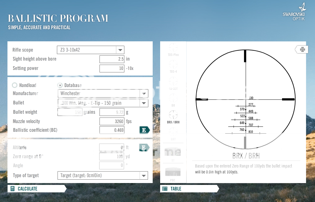

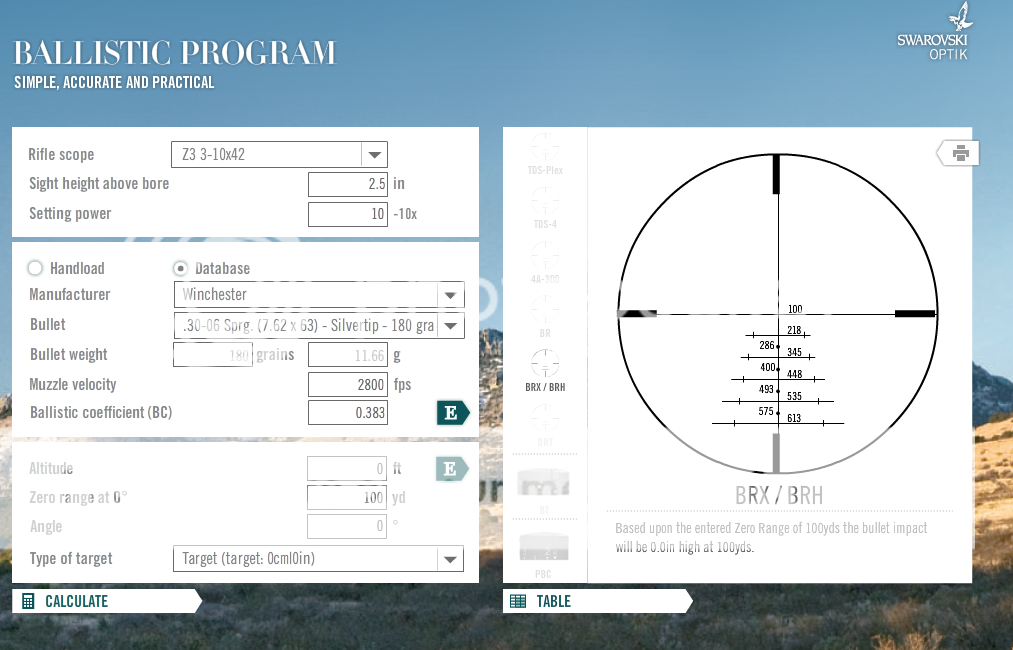

To continue my BDC rant, there are also BDC reticles which do not have numbers, but only lines and you have to have a piece of paper with the ranges you will look up. This is particularly the case with Swarovski BDR.
I'll spare you the experience of swaro calculator and you can just look at the following results:
You will not have the numbers in the scope, you will have to write them down and you will have to look at your numbers and when count the lines in the scope. So say your game is at 476 yards - look at the pictures imagine there are no numbers of the reticle and tell yourself where you should hold over. And with all that, don't forget that it has to be at the 10 magnification exactly, if you left it on 9 or 8 - it all goes out of the window.
I personally think that variable magnification second focal plane BDC reticles are the biggest misrepresented feature in optics. It is not easy, it is not convenient and is not precise in any sense. This point applies way less to fixed magnification and first focal plane scopes, but I somehow don't see much upscale optics with BDC, I wonder why )
