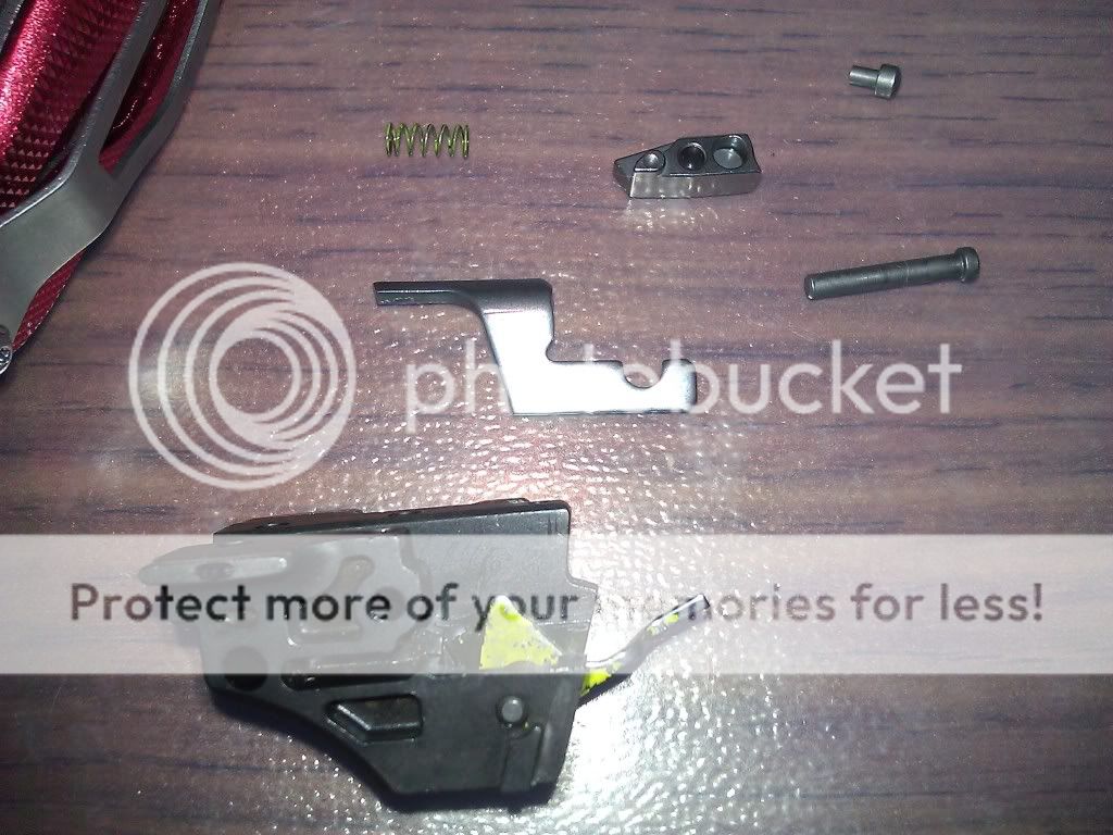

my problem is my sear housing that came with my m&p doesnt have a mag safety or a hole for one.

There is no hole for a mag safety. The yellow lever in the picture is the mag disconnect lever. You have remove it to eliminate the mag disconnect feature. You then reinstall the block using a longer spring to replace the thickness of the lever. Go to youtube there should be a video there on how to remove the disconect lever.
There are only two designs of sear blocks. One has a larger diameter hole for a larger sear spring. Otherwise the blocks themselves are all the same.

so where does the RAM install? and how come the one I posted on midway has the yellow lever but says Smith & Wesson Sear Housing Block "without Integral Lock and Magazine Safety"
The Yellow lever is NOT the mag disconnector, it's the sear drop (takedown) lever - the sear block shown doesn't have a magazine safety on it.
thats what I thought, thanks for clarifying. there seems to be a lot of people giving wrong information here. to my knowledge there are 5 different types of sear blocks for the m&p 9mm. one is the older one that has the small sear spring. theres a standard one which has integral safety and magazine disconnect (integral safety cannot be removed but mag d/c can) theres one with no integral safety but still has a mag d/c. theres one with no integral safety and no magazine d/c but also no hole for the apex m&p RAM (which is the one I have) and then theres the one on midway that I posted that has no integral safety no mag d/c and has the hole for the apex RAM.
