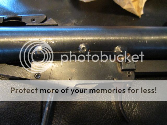

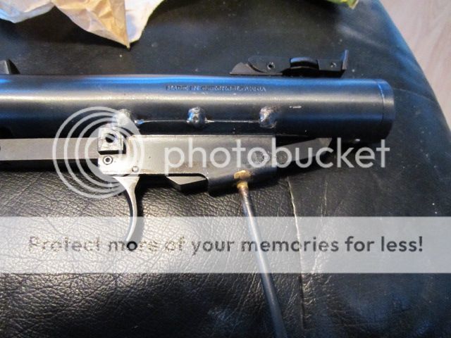

I of course don't have your gun with me but it looks like you might be able to drive out the pins, and maybe get the trigger & sear out after you remove the end cap, & ease out the mainspring.
Sounds like there is something wrong with the sear/notch.

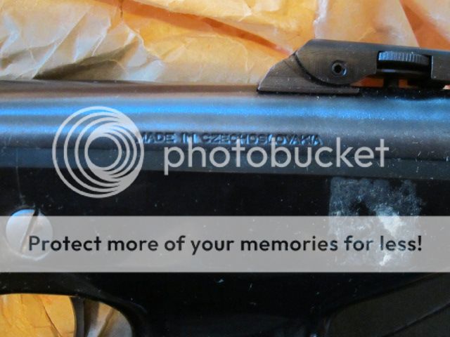

Nice pistol, looks like the little brother to the early 1970's Winchester spring pistols.
Have had the pins out a few times over the years...will try again someday. The more I learn, the more I see.
Silly question, but have you tried to back off the trigger adjustment screw? It may be set in to far and alowing it to fire as soon as the action is in locked position ? Just by looking at the last pic, it does look in too far.
Ken
Not silly at all. The adjustment has been tried in many different positions from all in to all out and 1/4 turn increments between. It still goes off when the action is closed.

Just thinking out loud - say if the pin holes locations were mis-aligned when they were originally drilled, if they were 'off' slightly, esp this might not give you enough range of adjustment to keep the gun from going off when you cocked it.
How would you check to see if this was the problem?
You are definitely in the hole wrt time spent on the problem, so what the hey.
***********maybe you could set up a jig to test what the sear geometry is with the piston, and test what the geometry is with the trigger/sear.***************
I am thinking this is probably the only way to find out what the problem is
I still think this is a problem with the piston / sear geometry.
*just a hunch.
I would wrap a rubber band tightly around the back end of the sear and the chamber behind the rear sight. This will hold the sear farther up into the piston. Now Very carefully(with pellet loaded) #### the action with the stock removed. As the barrel moves into the forward locked position, ensure the muzzel is pointed in a safe direction. If it does not fire,then your sear is defective. To fire, just hold it real tight and pull trigger and it should go SNAP.
If the sear does hold, LIGHTLY move the trigger back and forth to see how much freeplay is there. This will tell you how much the sear needs to be built up at the trigger end.
Ken
Ya know, the more I look at that bottom pic, the more I think Tony is right. The hole's for the sear pin should be 2 to 3 mm higher. It looks like the sear may be only catching the piston by a few thousand's of an inch. Should be 1/8th inch or more. If the rubber band trick works, I know the "fix" needed.
