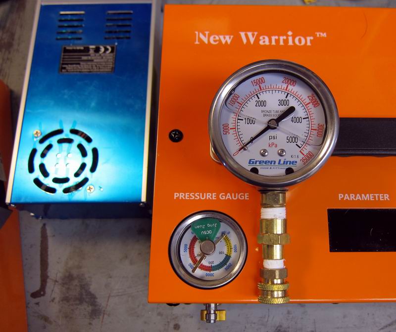

I bought a used New Warrior electric pump (12V or 110). $350 and it was like new. I believe new ones were about $550 at that time. It doesn't get much use but seems well built and is serving me well.
I installed a fitting on a gauge to set the max pressure cutoff accurately. It's quick and easy...
