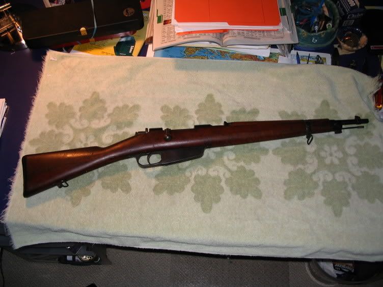

Ok gents, I'm looking for some not too common ammo. I inherited a Carcano carbine that's been sitting in the same unfired state since WW2. It's in damn good shape, albeit a little dusty and grimy. I'm itching to fire the thing and see how she shoots.

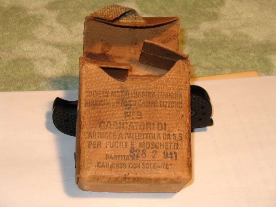

The only problem is I can't find ammo. I have one craptacular box of about 15 rounds that came with the gun but they're in no shape to fire and I'd like to preserve them, anyway.:)
So guys, where can I get some 6.5 x 52 Carcano rounds? If that's indeed what this thing eats....
(I've already checked out SIR and Wholesale with no luck)
The carbine is actually a lot shorter than it looks. (about 2" shorter than my Mossberg .22)

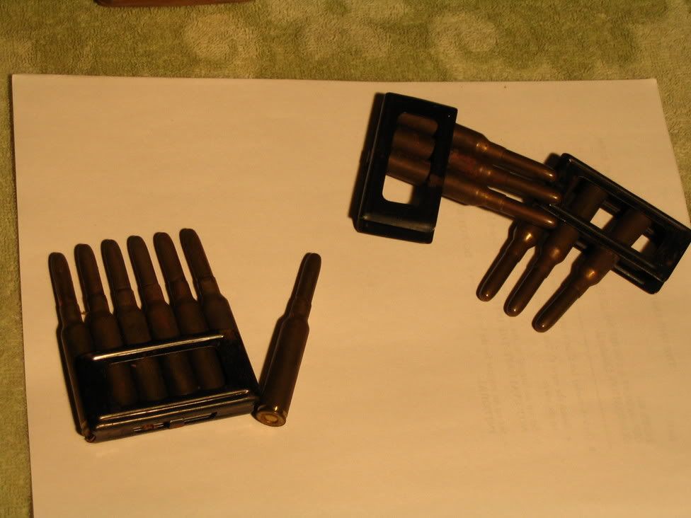

Ammo clips

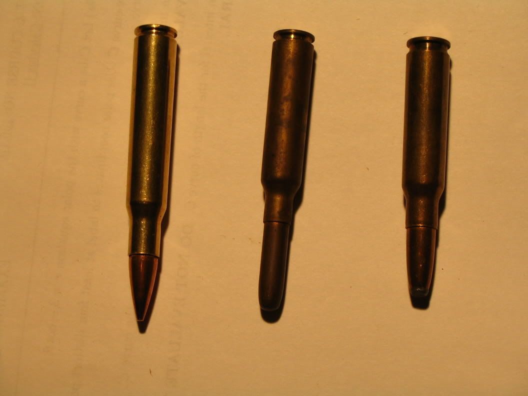

L to R: 30-06 Sprfd, 6.5mm, 308 Win
The box the ammo came in.

I feel your pain. You have the clips, so if you just want to shoot off a few rounds, shoot five or six of the old ammo you have, but be mindful that it's corrosive and will require a proper clean-up afterwards.
