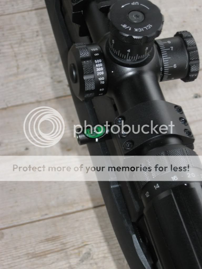

I got the B-Square bubble level for around 20-25$ on ebay, couldn't find anyone in Canada who had it on their website back then.
Mine:
