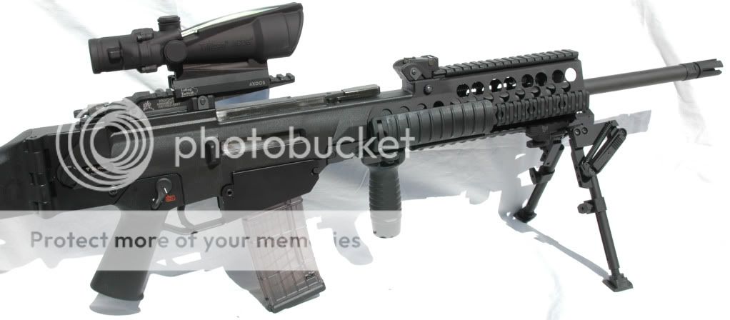

To give you and idea on the TA-11 on a HK . The scope was throw on just for a pic. Normaly have it a few slots further back

I wouldn't get an ACOG. I would be looking for an accu-point with some supper low rings.
Even some 1 like me with a really big mellon would have a hard time shooting this type of set-up in any position.
