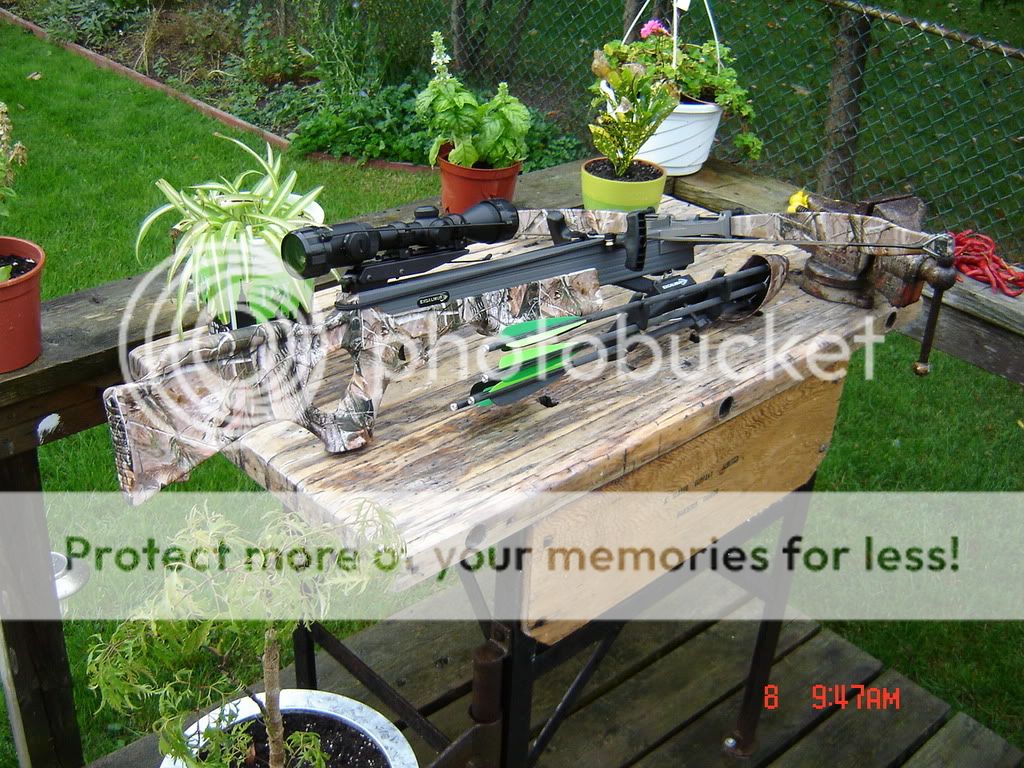

I bought this equinox last fall after hunting with a buddies crossbow a few times. He had the vixon i think. It was pretty slow and you had to aim high for longer shots without much velocity when it got there. (the faster the better as your worst enemy is sound of the bow snapping beating your arrow there)
My Equinox has sound dampening pads on the limbs but it still sounds like a 22 rifle going off.:eek:
Have you tried pulling one back yet with the pullies? It's actually a lot easier than it seems. I let the neighbourhood kids take a few shots last year in the yard and most could pull it up themselves.
If you're hunting moose and bear you need something that can penetrate bone (softer bone like ribs and such) on a poorly placed or overhead shot.
Good luck with the hunt.
