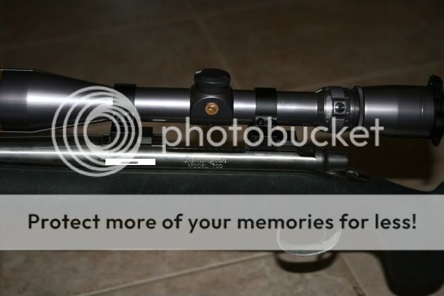

I'm looking for an alternative to these low Weaver steel/aluminum low mount rings. Are there any other low Weaver-slot rings out there that don't start at medium height?
The rings pictured are actually medium height. Lows are much thinner at the base.
Ted
This is correct. I just wanted to illustrate the type of ring that I've already got.
There's nothing wrong with these Weaver rings. I heard they actually hold a scope much better than most others. I just want to know what else is out there.
Much sturdier ring. The thing about the Weavers is that they are prone to leaving marks on the scope and the scope can rotate when tightening which is a PITA trying to get the scope level. I have both Warn and PRW's, much better and worth the $ IMO
