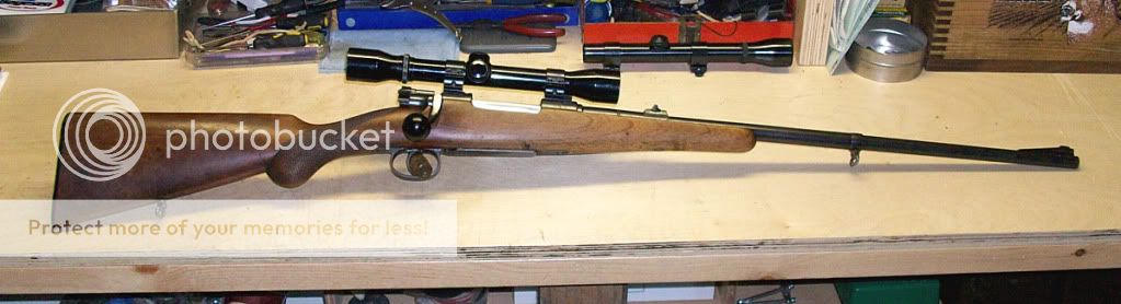

Here is one in 9.3x62 that I picked-up from Trade Ex. It weighs 7.6 lbs with a sling and a 4x32 Bushnell. I just need to have the over-sized bolt handle replaced.
