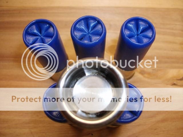

Cool on the finishing tool. I looked at setting something up some years ago but never had any issues with the taper so didnot.
As you know you are producing better than even factory crimps with that set up.
How are you using it your supersizer mounted to a board which in turn is bolted on a small table top drill press??
Do you have to lube the end of the hull.
Going to try to find a pic so the boys that have never seen what this small item and simple step once set up can do
Cheers
here we go talk about sweet crimps and just look at that taper
The supersizer mounts on an adaptor plate I made up. For the GAEP I use an adapter they make to hold the shell. I do add a dab of oil on the GAEP to lube it every few shells. I have the GAEP for 28,20,12 and 10 gauge. I usually keep the MEC crimping loose and finnish of with the GAEP. It saves times adjusting for different loads. Love those things.
