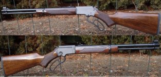

I am reluctant to buy another Chiappa firearm for the reason that parts are very difficult, if not impossible to obtain. I ended up making my own all steel magwell for this M1.
Grizz, that's awesome!!
Do you have any more pics of your process, what was the time frame it took to complete?
I need my daily fix of EYE CANDY!!! :LOL:
I went looking for old pictures, and I couldn't find any. It was a labor of love. Tiny bits of metal, tig, mig, and jewelers files. I had to work from pictures, not having an original to copy. It works 100%. I bought the gun from someone here on the EE, who had taken it apart to clean it, and lost the mag well. I think the original mag well is plastic or aluminum. I thought of 3d printing one, but in the end it was simpler to work with my hands and fabricate one. I've done a few crazy, time wasting projects like this. Hey, its a hobby.
