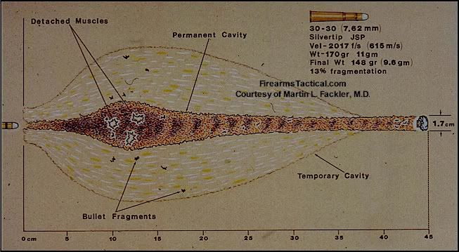

Its a little misleading to compare the terminal performance of a high velocity rifle bullet to that of a rifled slug. One aspect we must consider in the terminal effects of the high velocity rifle bullet is supercavitation. Supercavitation occurs in fluid and soft tissue, though not in bone. While the bullet's velocity exceeds say 2000 fps, the expanded nose effects the shape of a gas or vapor bubble around the bullet, so very little tissue or fluid actually makes contact with the bullet. The tissue the bullet passes through while at high velocity is displaced violently, leaving a permanent wound channel several inches in diameter. As the velocity of the bullet decays to say 1500 fps, so too does the size and shape of the gas bubble around the bullet, and the diameter of the soft tissue damage is reduced. As velocity slows, the bullet begins to make contact with both tissue and fluid, slowing more rapidly, and at this stage the permanent wound channel is only as large as the frontal area of the bullet.
In the following examples we can see the effect that velocity induced supercavitation has on wound diameter and depth of penetration. But note how the diameter of the permanent wound channel is reduced as the velocity decays . . .

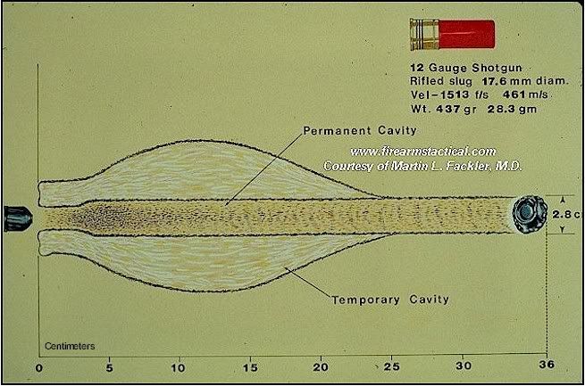

The shotgun slug has a somewhat different performance envelope. The muzzle velocity of the rifled slug never comes near 2000 fps, and according to my chronograph, even 1500 fps is pretty optimistic regardless of the claims by various manufacturers. At these low velocities, only the frontal area of the bullet contacts tissue. At first this seems like an argument in support of the expanding slug, until we realize, that the slug is light for caliber, with low sectional density, and that any expansion or upset of the slug will adversely affect penetration. For this reason, I believe the non-expanding slug produces the best terminal performance, which is why, for my purposes, I prefer Brenneke and Challengers over foster slugs. However, when the target is a deer, and the slug is fired from a rifled barrel, the new breed of copper slugs produce the accuracy necessary for long range hits (long range for a slug that is). The difference in penetration that expansion has on a light framed animal like a deer, won't effect the outcome, provided the shot was a good one.
In this example note that the permanent wound channel only matches the diameter of the low velocity slug . . .
