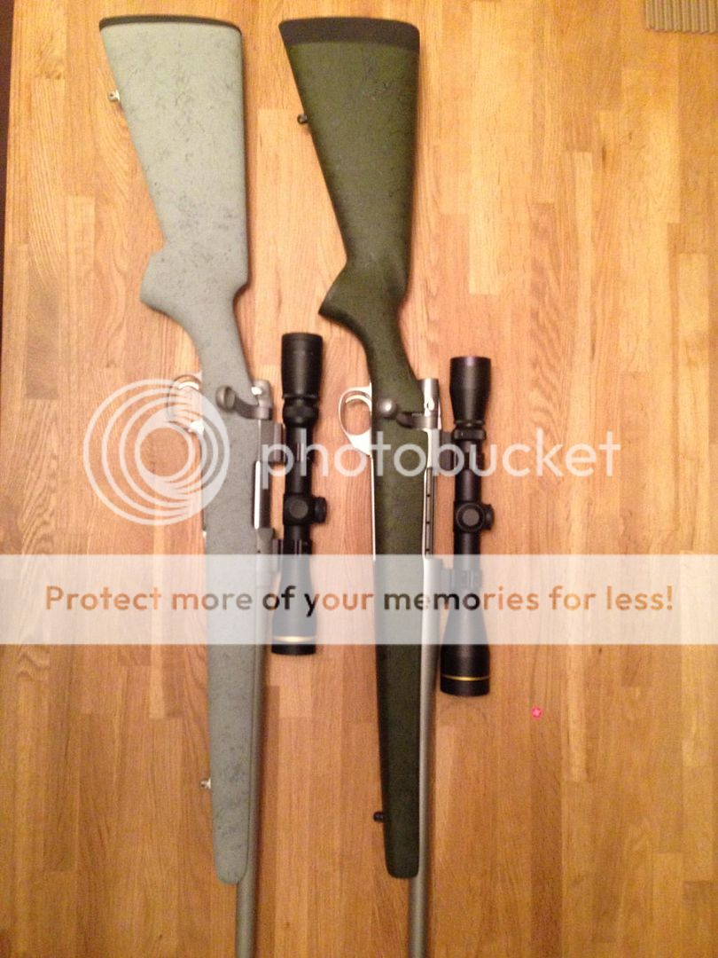

I have a Wildcat and B&C. Left picture is the wildcat and right is the B&C. The wildcat is much lighter... I had Stuart make it as light as possible for me and still have enough strength for 7mm SAUM recoil and not be too weak for sheep hunting. The Rem700 saum comes in at 6lbs 5oz's scoped. Not too bad. The 257wby with B&C comes in at 8lbs 8oz's.
Sweet rigs 7mag! Would be pretty sweet if I could get mine down around that 6.5lb mark.
