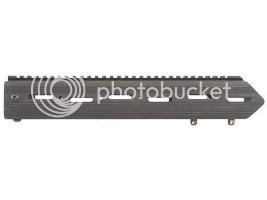

I'm looking to buy a discontinued Badger Ordnance Stabilizer Handguard and I'm wondering if it will fit my a Armalite AR10. The person I'm buying it from had it on their AR15. The barrel nut looks to be the same, but I'm new to AR10s and don't know a whole lot about what parts are interchangeable.
Any help would be much appreciated. Here's a pic of the handguard I'm talking about.
Barrel nut is not the same. An armalite barrel nut isn't even the same as other .308 AR's, It's larger in diameter if I recall. I also think the AR 10 version of the handguard like you have is larger overall. I think the to rail is quite a bit higher. I have one on my AR10, and I recall it was to high to fit an AR15, so if you have an AR15 version it would be too low. All of this is from memory since it has been a few years since we tried it. I know we custom made the nuts to adapt one for a friend, and it looked so odd he never used it

The thread for AR308 and AR10 are the same diameter but a different pitch.

Most companies that make handguards for AR10's offer barrel nuts for specific riflebrands. Wolverine generally offers handguards for .308 AR's, and right next to it offerthe same handguard for Armalites
As Dogzilla mentioned the AR15 one won't work. There is however an AR10 version as seen on the Canadian DND uppers. You should also know there were apparently two versions the four screw version as seen againon the DND rifles and the two screw version as seen on the picture above by the OP.
On one hand these handguards are awesome. Add on rails, two sling studs at the front, free floated, have that German purpose built look and are really tough. Plus they sit really well in a front bag. They are however very heavy.
I have two DND AR10 rifles with them. I wouldn't change them for those rifles for the above reasons and it keeps them as accurate rare examples. But if going for a handguard today I would look at other options. Noveske NSR keymod, MI SS G2 keymod or for a modernized version of the Badger I would want an AR10 version of the Diamondhead T handguard (same sort of look but more up a bit). I don't think they make one for AR10 or 308AR rifles. If they did I'd go that route.
