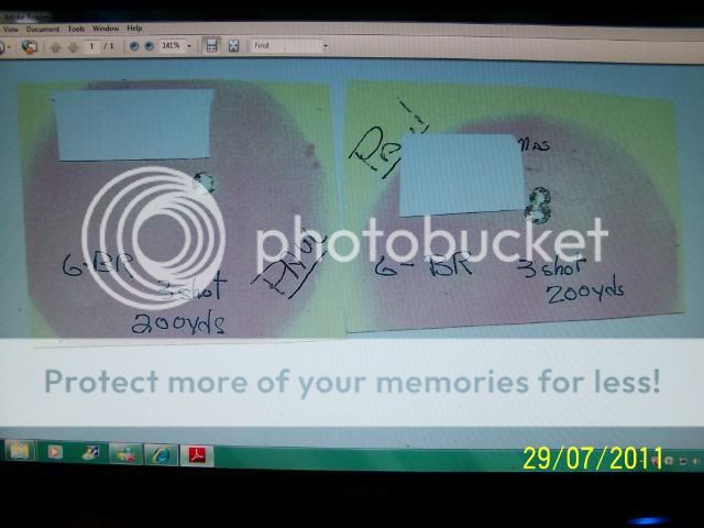

Freind who has won the Nationals USA sent me this target shot with his 6BR
seems like a pipe dream anything will shoot better than the 6mm after looking at target on left and thats 200y
