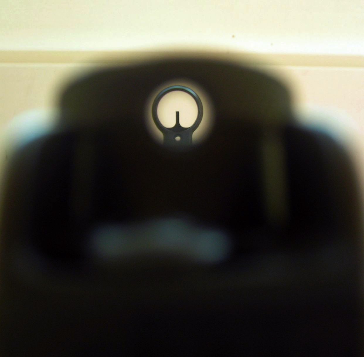

The way I use my Williams firesight rear, is to remove the insert so the hole is bigger and line up the hole with the front hood so that they overlap each other, and then aim the top of the front post. The front post has to be set higher because the rear sight cannot be lowered beyond a certain point. Therefore if I line up the rear sight to overlap the hood, the front post is not at the centre but above the centre of the rear sight hole.
Since I cannot adjust the rear sight any lower, if I were to lower the front sight post to the centre of the rear sight hole, then my POI will be several inches higher at 50 yards.
Is it okay to have my front post above centre in the rear sight hole? Should I just NOT line up the rear hole with the front hood (ignore it) and just line up the front post with the centre of the rear hole? What do you think?
