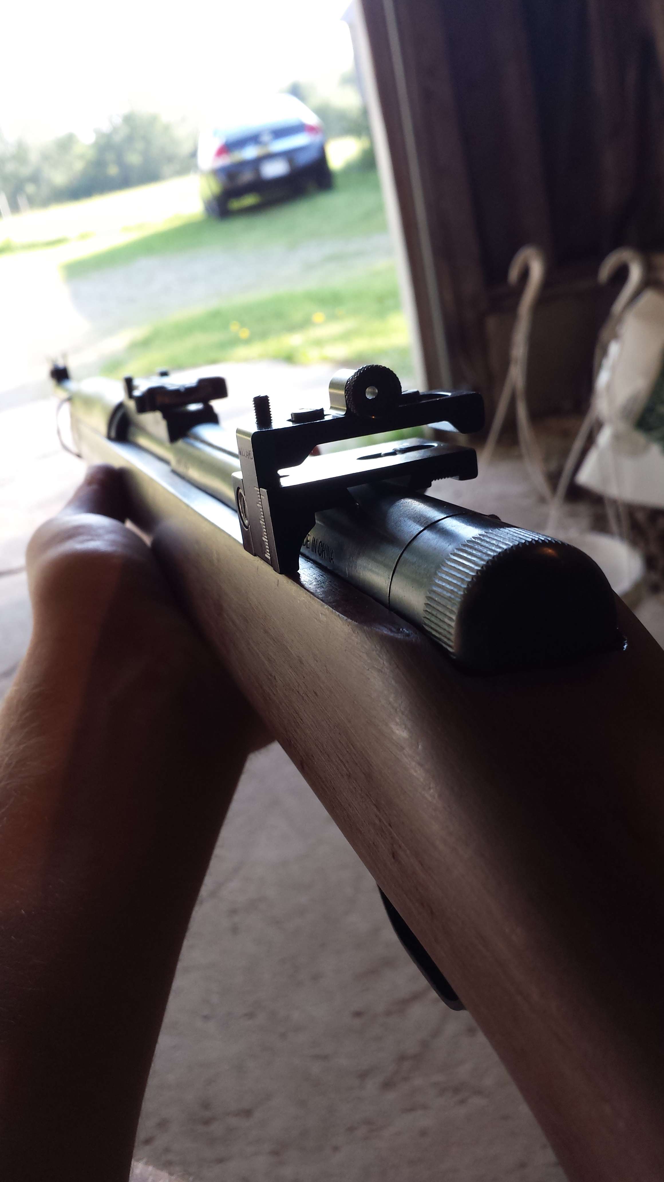

I put a Skinner sight on mine. It's made for the JW15 (same as CZ) and just tightens on to the dovetail. I did need a higher front sight blade. I also got the adjustable aperture with the Skinner, so peephole size is no problem. However, the Williams sight will probably be easier to adjust. I have one on a Savage FT and it's very good.
Extending the sight radius was huge on my jw-14. I use the gun as a beater pinker camp gun. Lots of friends comment about how easy it is to use.
It looks a lot more compact and tidy; very fine workmanship.
