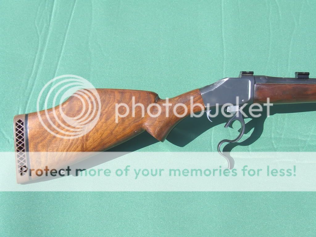

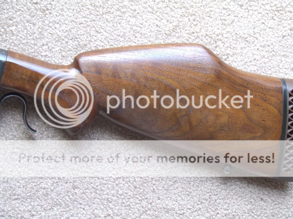

Here are pics of an older B78 for which I built a stock from a chunk of 2 X8 walnut.
Nicely done!
