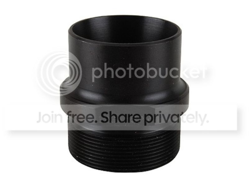

At the muzzle there is a machined lug or flange, something like a bayonet lug. Is this for a removable choke?

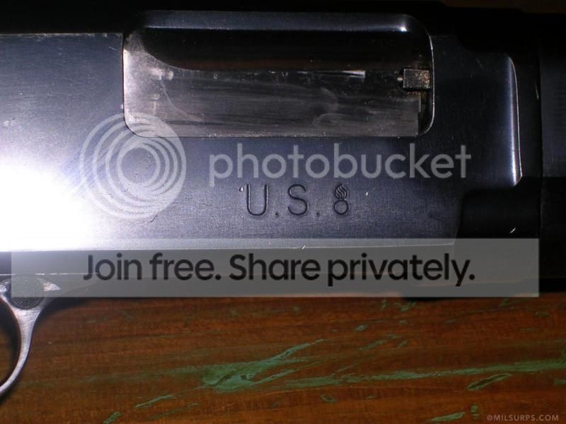

hey gander has it got a U.S. and ordinance bomb stamped on receiver? and is it a 20 inch barrel or is it longer?

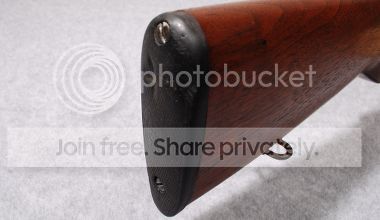

riot guns were blue with a red butt pat, trench guns were parkerized with a metal butt pad.

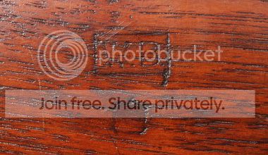

All the Military Model 12s are factory marked on the right side of the receiver under the ejection port with a "US" and flaming bomb. There is also a small hand stamped flaming bomb on the top of the barrel next to the Winchester proof mark. The Military guns also have buttstock marks. The vast majority of the riot guns have a WB mark and crossed cannons mark on the buttstock while the trench guns have GHD stock cartouches and crossed cannon marked buttstocks.No "mod" stamped barrels either

Many model 12s of that vintage were fitted with adjustable choke devices of their time. My guess is it may be related to a "Cutts Compensator" that has been removed. Just a guess though.
All models 12s "take down".
Pretty good guess. Sure looks like a cutts insert that has had the end machined or cut off.Some had a flat spot also which I can almost see I think in the OP's pic.
I would go to shotgunworld and post this on the winchester lovers forum. Those guys really know their model 12s.
As far as value goes, if it is a cut barrel 12ga field model, it won't be worth much. Maybe $200. Too bad...
It is what's left of a Cutts attachment. The vented cage would attach to it then the threaded tube/choke. May even be what's left of a Pachmyer choke which was very similar to a Cutts. being stamped MOD indicates the device was installed after purchase.

I would say price wise you are correct just cannot see what makes you think is it not a cut field model. Again I'm no expert on model 12 but do watch for the special ones since they have good resale What am I missing???Wrong serial number range, wrong choked barrel, no special butt plate or inset swivel in stock is mentioned and there is not one of the special marks the experts look for. If it has even one of these I may question further but it has none or maybe it does it???. take care
