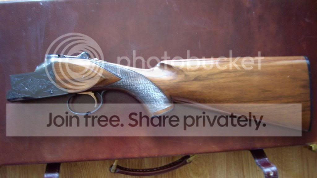

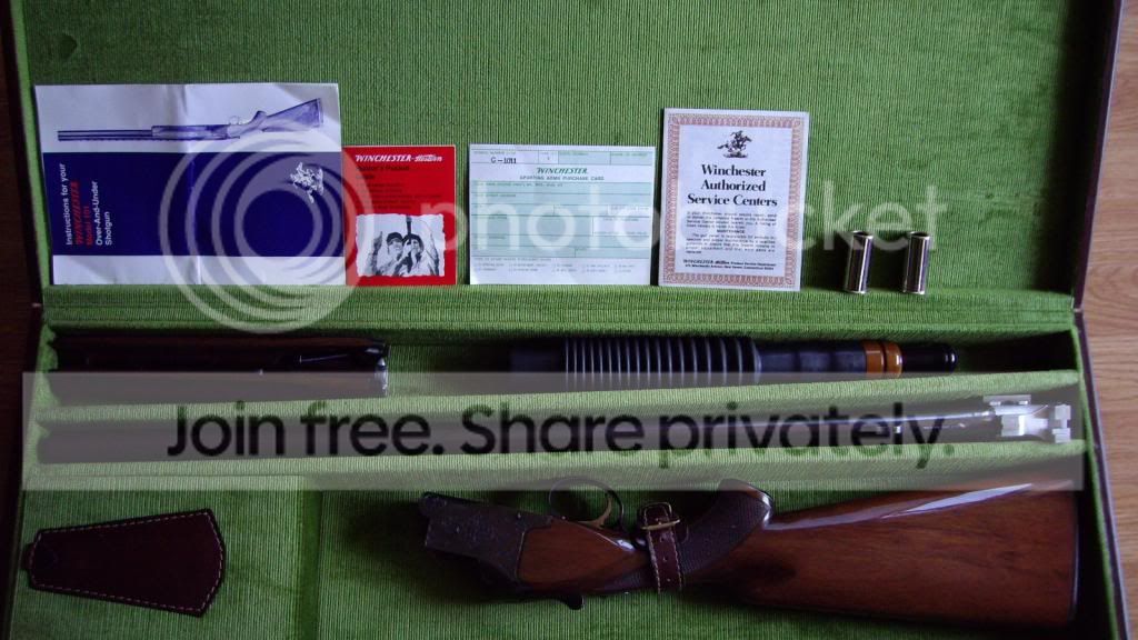

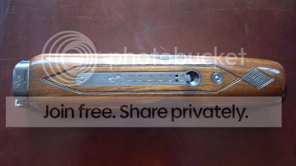

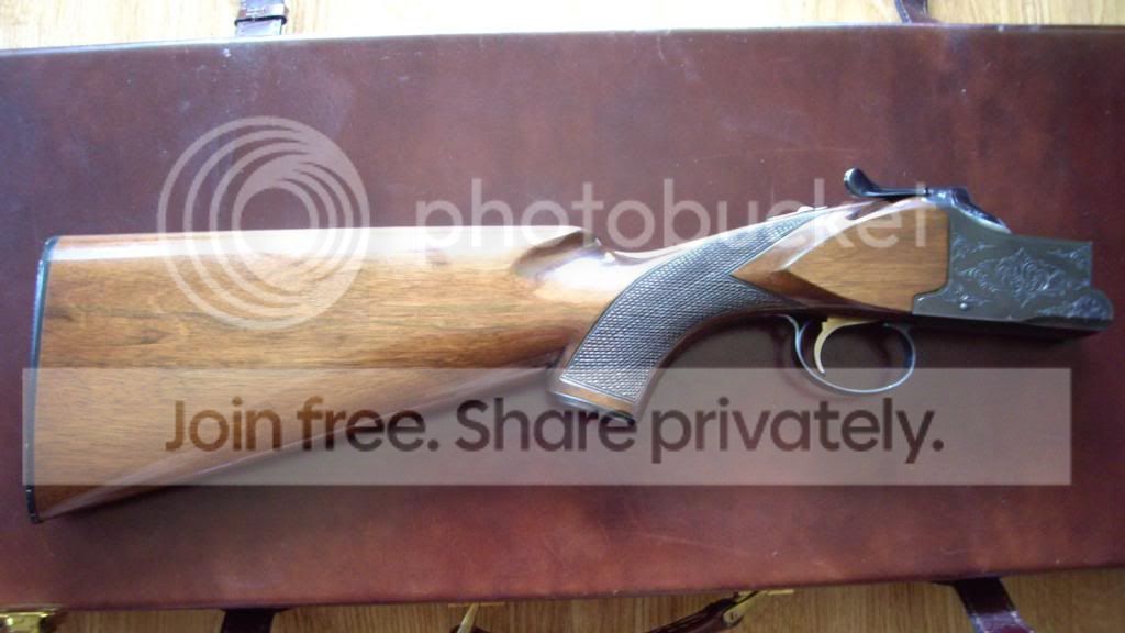

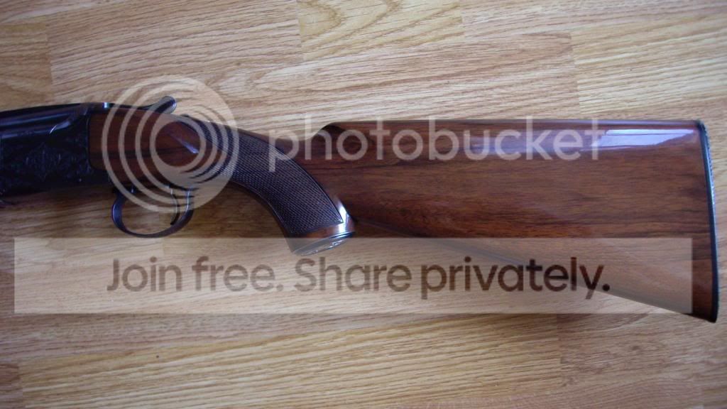

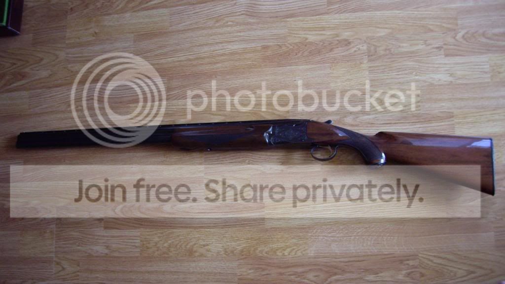

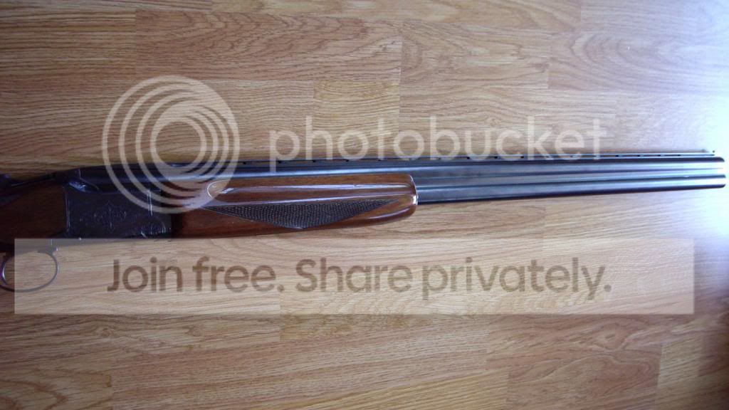

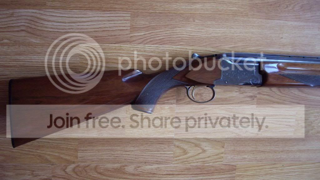

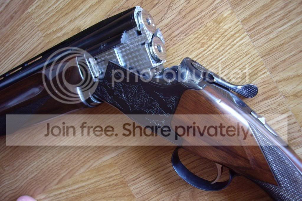

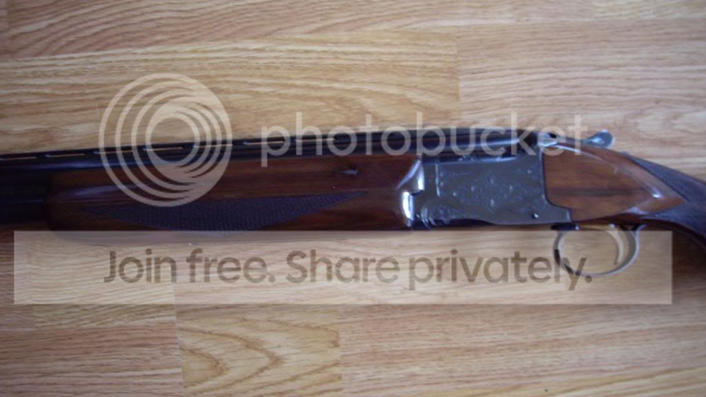

Hello again, thank you for all the input. I picked up this Winchester today, here is what I acquired.

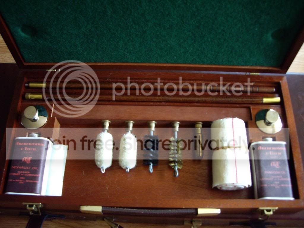

And a bonus Abercrombie & Fitch Deluxe cleaning kit.
Yes I did not haggle on the asking price. The seller said he had only put three boxes of shells through it. I figured it would be a long time before I was going to see another one in this condition. I am happy thank you.
He even through in a scotch duck call ! Very nice indeed congrats !
Y'a done good on the 101. As for the Scotch Duck Call ( a.k.a. "Horsecock" ) ... no self-respecting waterfowler would be caught dead with such a rude contraption. Get it out of the gun case & bury that thing - or at least hide it away ! ;)
