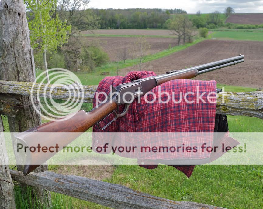

The Rifle: This old rifle is an original Winchester 1876 with a 28” round barrel and chambered for the venerable .45-60 cartridge. Although the serial number suggests it was made in 1884, the factory information from the Cody Museum states that it was received in the Winchester warehouse on May 13, 1886 and shipped September 21st, 1886. The factory records indicate that it was ‘R&R’ on October 3, 1895, indicating it came back to the factory for something, though I have no clue as to what. The gun letters as is. Here is a photo of the vintage Winchester 1876 ...
