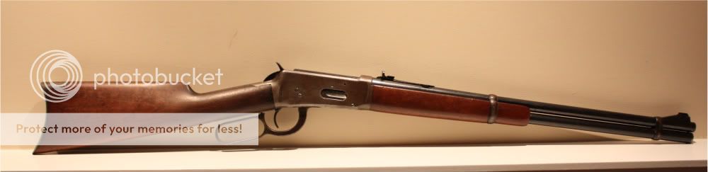

I purchased a winchester 1894 the caliber is 25-35 it has a 5 digit serial number putting dating it to be 1895. I am looking for the winchester collector out there who can tell me more about what I have.

The front sight ramp on that barrel does not look like any very early 1894 rifle I have seen. Believe at the minimum it's been re-barreled or cut back and an after market ramp put on. The barrel is more typical of those found through the 1930's/40's. You may have a well done rebuild and it is still a useful rifle but lacking collector status.

It looks like to me that at some time some one married a later carbine front to a rifle riecever/ but stock. Just looked at Madis The Wincnester book and the only front sight ramp like that was on a carbine serial about 1,300,00 range. If it ir a carbine riecever it should have a saddle ring on the other side. Hope this helps.
From the Winchester book the marking of the model as Model 94 appears about serial 1,040,000, the barrel also read MADE IN NEW HAVEN ,CONN.US OF AMERICA. At about serial no.1,900,000 the marking changed to read MADE IN U.S.A. This might help date the barrel.
The barrel is definitely not original to the gun, with the Model 94 stamp and the ramp front sight. The carbine also has a rifle buttstock, which is probably a replacement as well. That being said, there would be little collectors value to the gun, but I must say it is a very nice looking little carbine just the same. There is history behind those modifications that make the rifle unique.

It is a very interesting gun, the action is tight and over haul the gun is in good condition. Probably not a great collector piece, so I am considering a rebuild,,,reblue and wood refinsihing.
Acording to what i see in the book it states that that marking was mainly used for barrels that were made as replacement barrels, starting at about 500,000 and on.
Well, if it were me, I'd leave it as is for two reasons:
1. A refinish job would likely diminish its value further unless you had a professional restoration back to factory specs, but you would never recoup your costs.
2. I think the carbine looks dadgummed good just the way it is. Some owner back in the 30's or 40's valued that rifle enough to have it re-barrelled and fixed up to give it a new lease on life. The result is a very attractive looking little carbine. I especially like that crescent butt.
