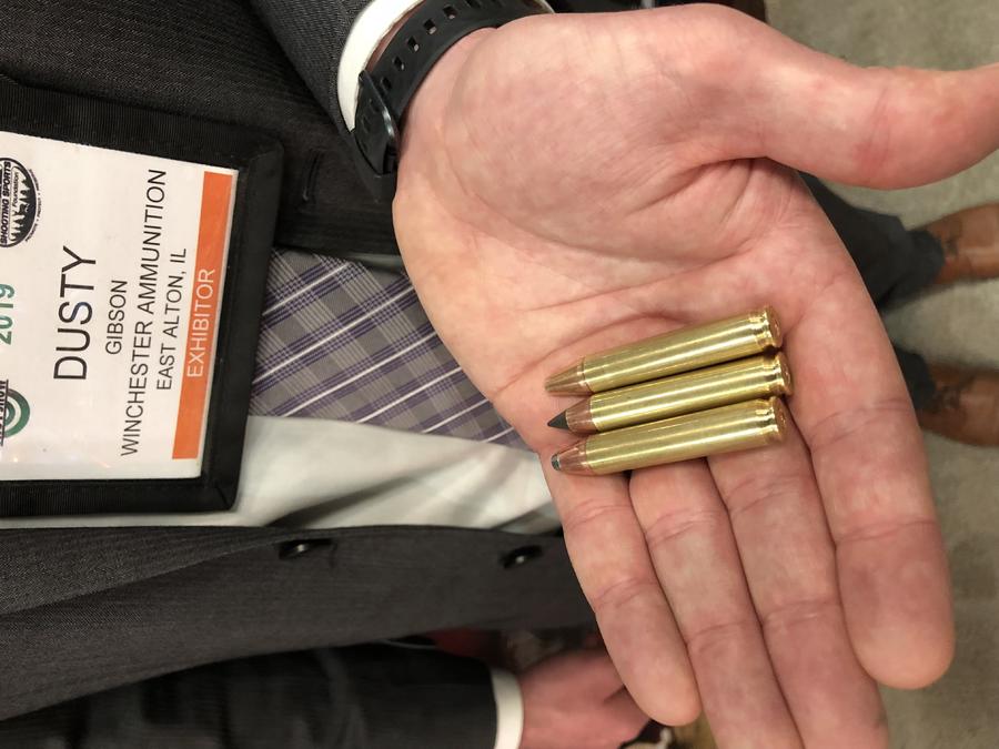

After several requests for ballistic specs on Winchester’s new 350 legend cartridge here you are :)
