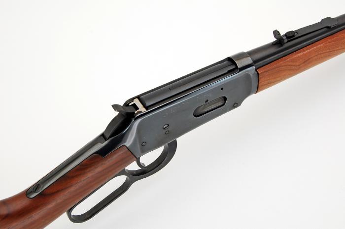

Angle eject pic:
Standard receiver

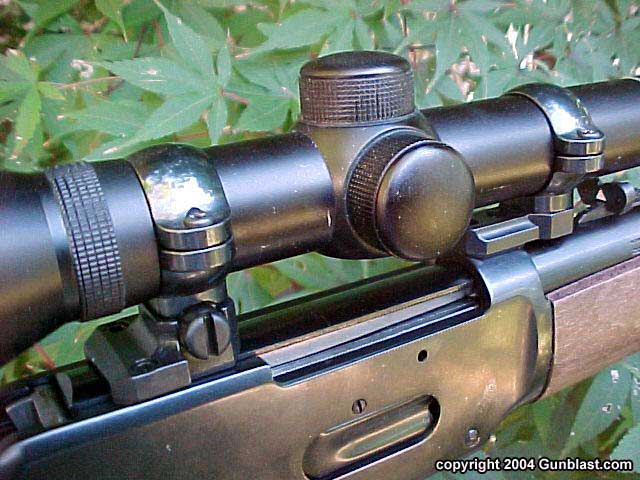

Side mount on a '92 Winchester (Ok, it might be a Browning)

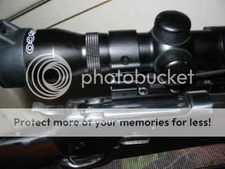

standard pic with scout mount
