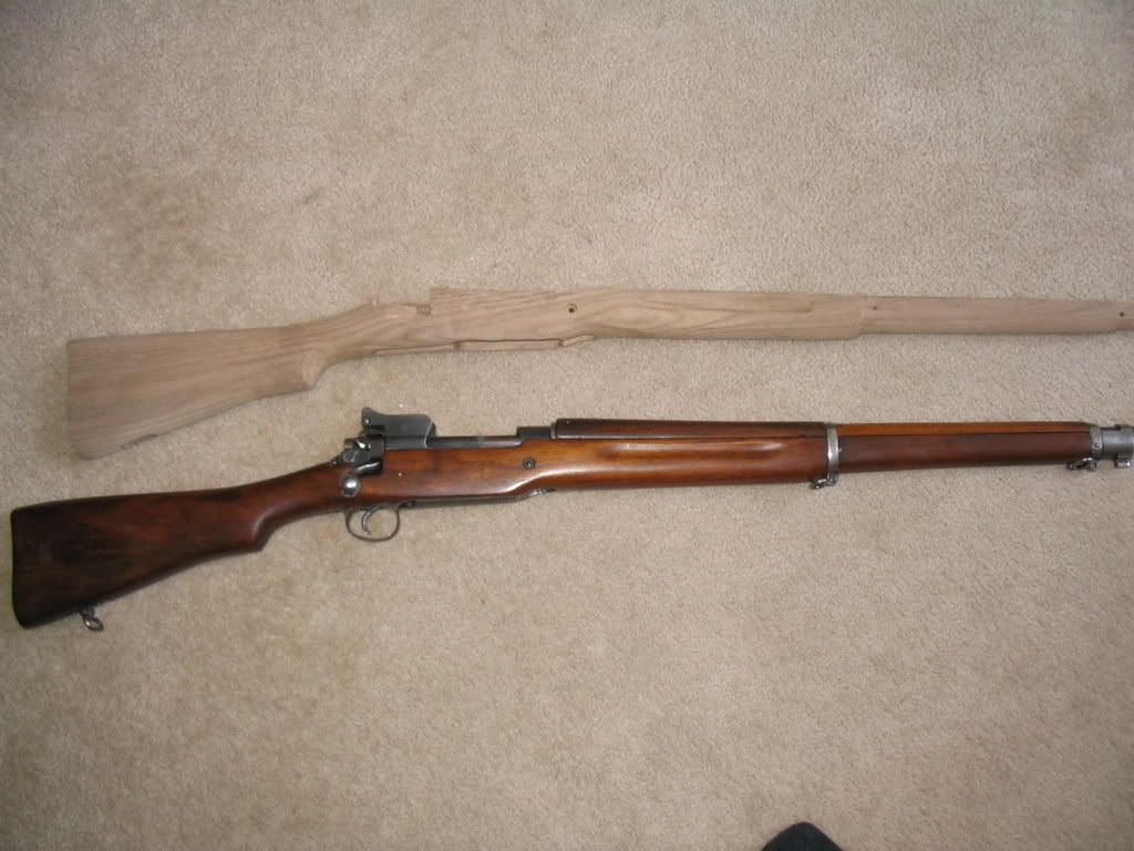

MRCLARK said:
sh%it Hitzy were did you find that mint stock?
That would save me alot of scrubbing and sanding to get mine looking good again.
Want to sell it?
It was part of the deal with the gun.......and it's already sold.:)
It was a Boyds, they make them for the 1917.
