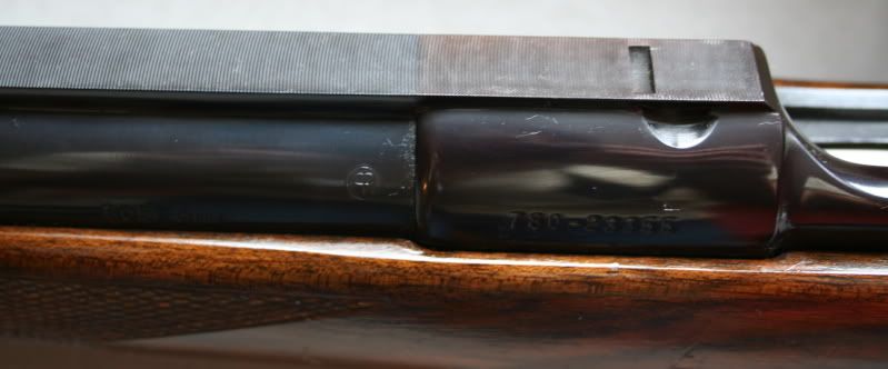

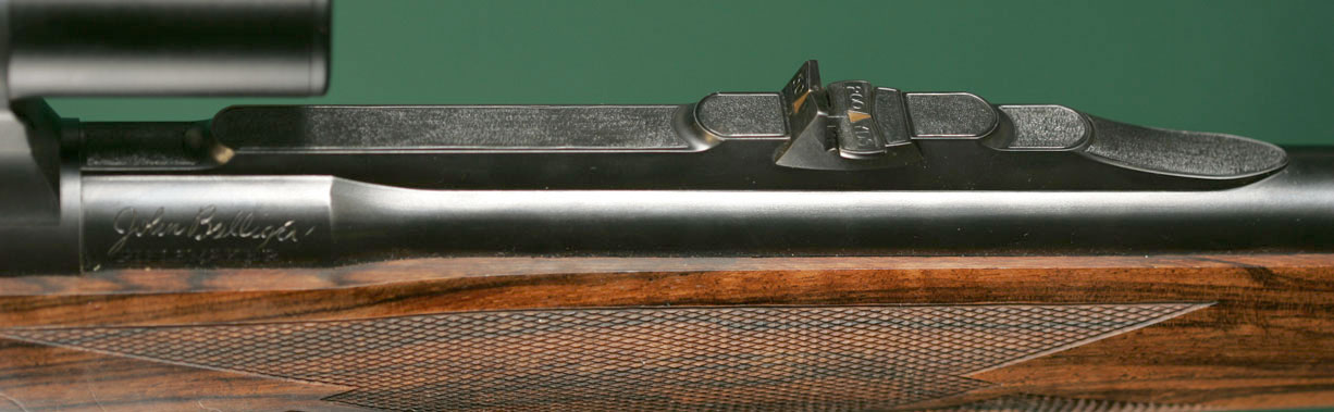

The quarter rib is the raised metal that runs along the barrel starting at the receiver, upon which the rear sights are mounted. Here's a picture of my RSM with the a closeup of the rib -
It is an expensive option because it is a machined part of the barrel (not soldered on), and prevents normal lathe turning of the barrel.

I also notice in the photo above that the bluing on the receiver looks just like mine did, i.e. a sort of plum colour, not matching the deep blue-black of the barrel. I thought that mine was just an isolated specimen...maybe not? It's strictly cosmetic, but you notice it every time you pick it up, and eventually it starts to gnaw at you a bit...

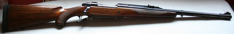

I noticed stickhunter's RSM didn't have a black tip on the forestock while 1899's RSM did. Is one of these rifles of older vintage? I'm starting to lean towards the Ruger due to its chunkier metal, longer action and greater weight. This will be my largest caliber if I get it. I would prefer weight over recoil.
