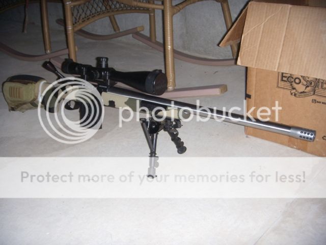

My Winnie Model 70 build with Benchmark 6.5 ( well, .260 now) barrel from Gary Eakin.... McMillan stock in GAP Camo.... Shoots better than I can hold it!
Enjoy the building process! :wave:

Barney,
What bottom metal and mag set up is that? Any significant modifications to the bottom of the action required?
