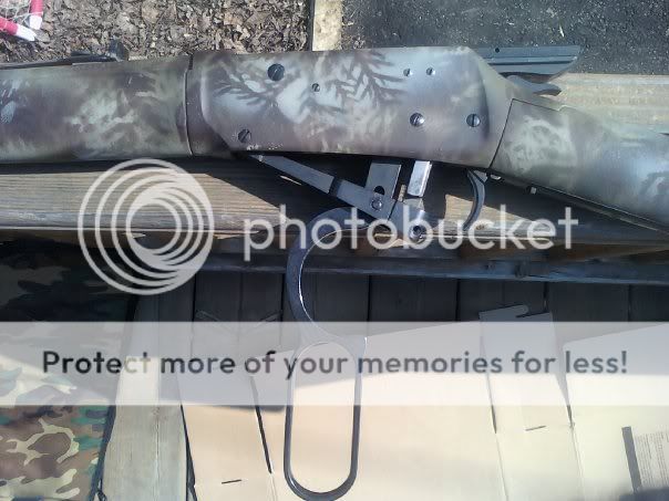

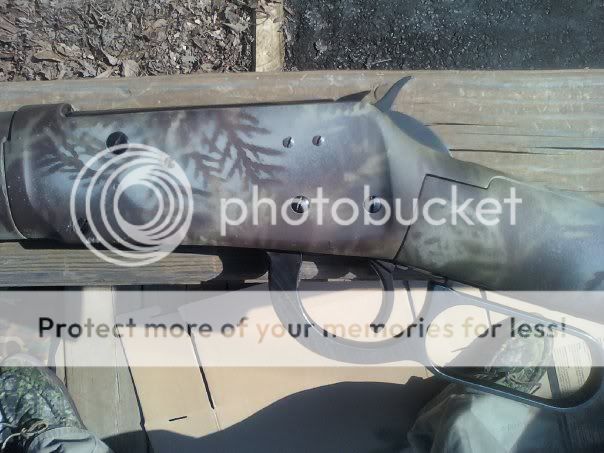

Both the barrel and stock were not in good shape. The stock I sanded down and smoothed out. The lever, hammer and top action I took steel wool to and then re-blued them.
Levers sure do look good 'stock' but I wanted something different. I was really happy with the final product.

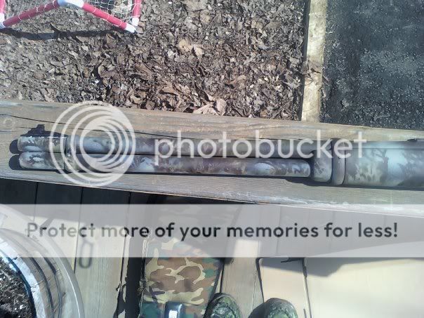

Once disassembled, I started out taking steel wool to the barrel and action to remove the rust. I removed all the insides and exterior screws. I HATE PAINTED SCREW HEADS!

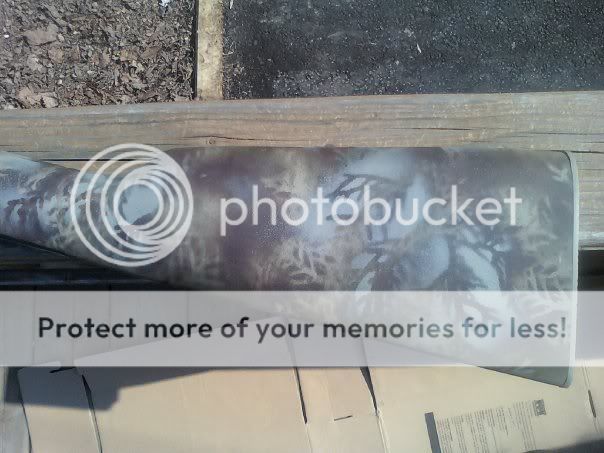

I then sanded down the stock and lightly sprayed an exterior textured furniture paint to give the stock a little grip. Here's what I used:
For the barrel and receiver, I covered them with a grey metal primer taping off the sights and the mag loader slot. Once they dried, I did a base coat of olive. The paint was made by Krylon and I picked it along with Brown and Green from Canadian Tire.
The stock was then done to cover the textured paint. Then I put the stock and barrel back together minus the lever and inside mechanism. I just wanted the camo pattern to be carried through the receiver and stock.
As Calum suggested, I used a cedar bow as the stencil. I started off with the Brown and then Green and then did Olive Drab again and just layered the camo.
I did not put a clear coat over the final product because I would like to see how it wears first.
