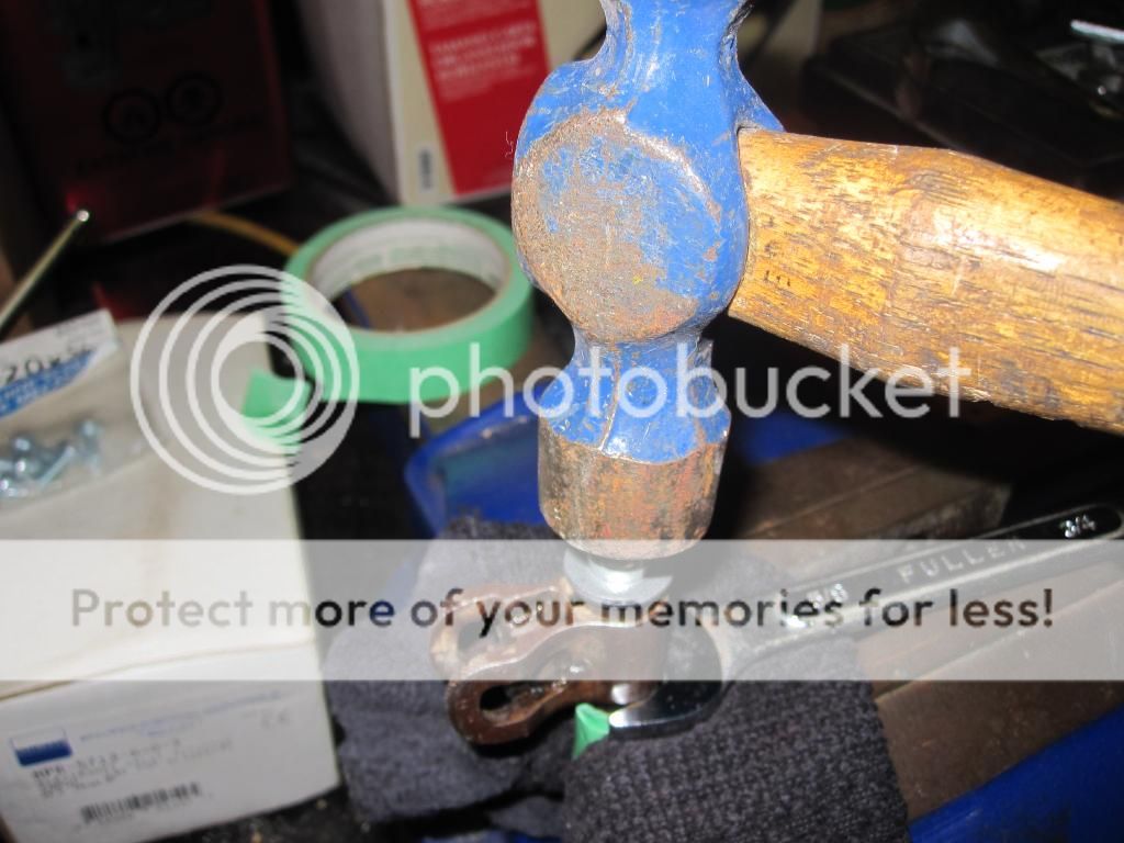

Hi koesdibyo... I just removed my own P14 sight just an hour ago... I 'll post it here... hope this might help you out.
I swear, mine felt like it was welded on. I think after 100 years the molecules must 'drift together' or something and become almost a solid... anyways:

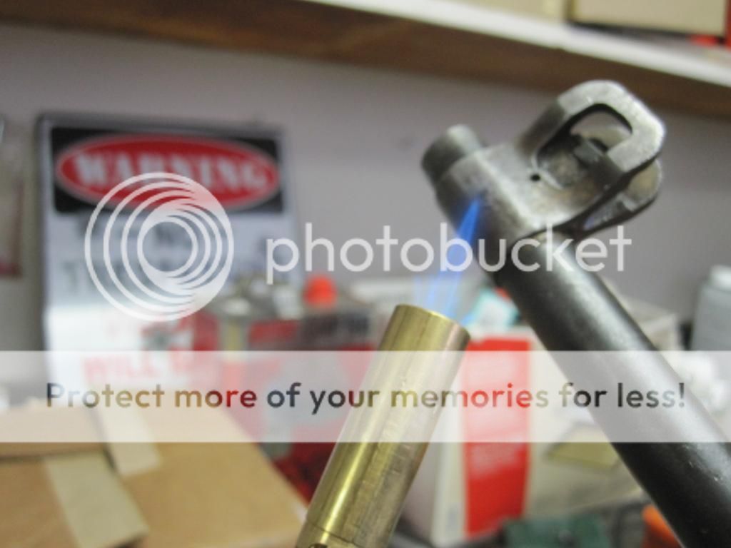

2) Heat up the base, hot... don't be afraid to get it really hot, wet your finger and it should sizzle
3) Use masking tape to protect your blueing... don't worry if it smokes or sticks... you can clean it off later.

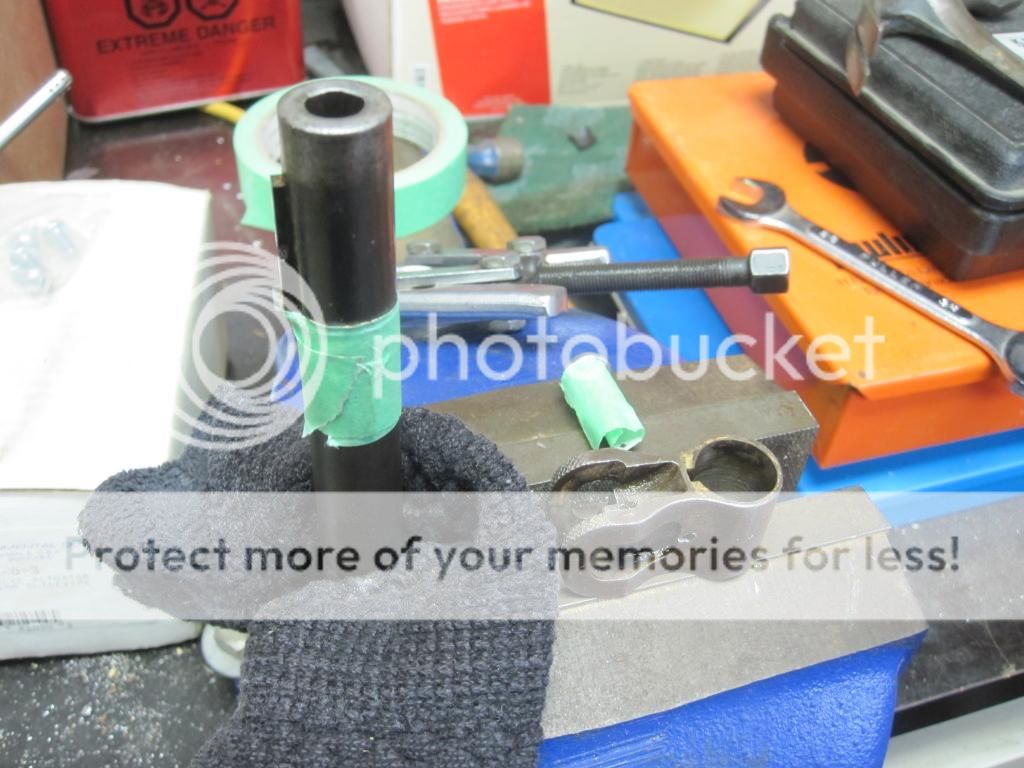

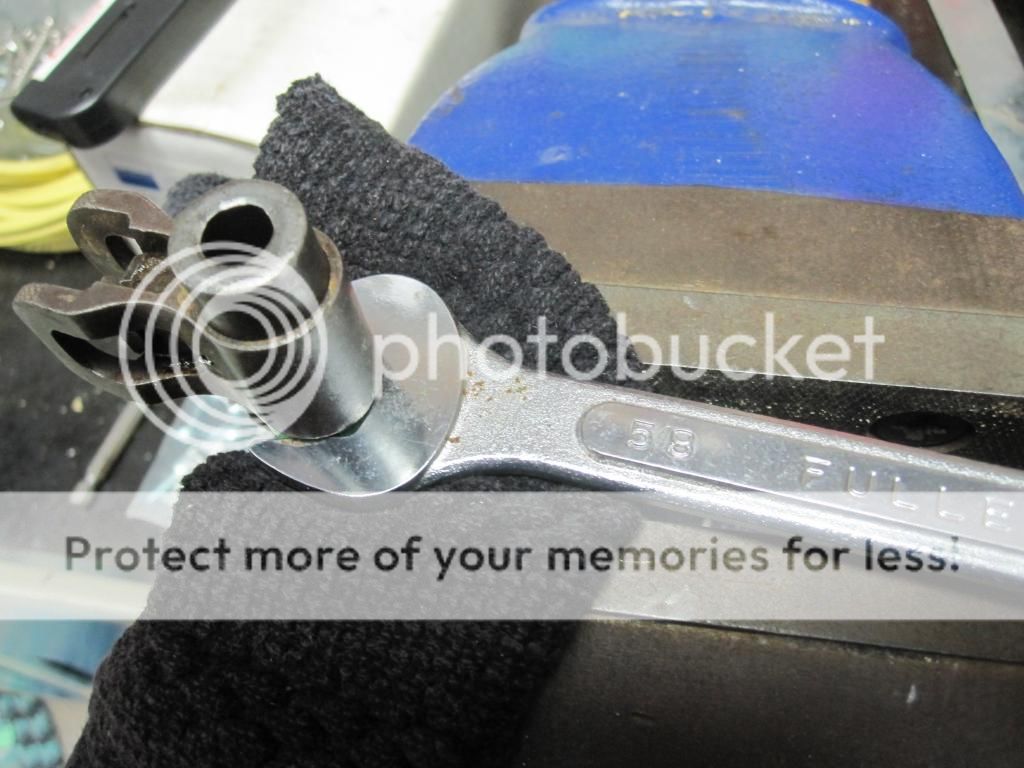

4) The tape will help center the 5/8 open end wrench you need to support the base on the vise... don't forget old sock for your blueing!
Orient the wrench like shown, to avoid running the sight base key into the wrench and buggering everything up.

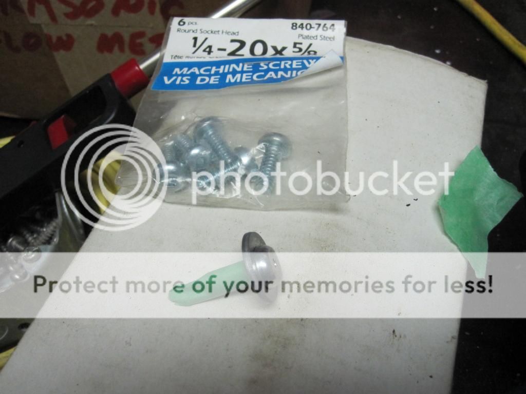

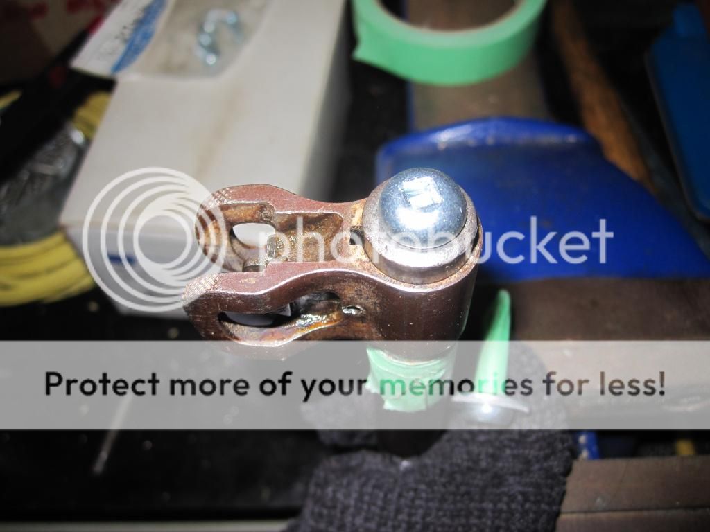

5) This is the magic piece... make one up in advance from a 1/4" Robertson screw ( the square head will be useful later) and a washer ( the washer rides on the crown of the barrel and will not contact or bugger up your rifling) and wrap the threads in masking tape so it just slides into the bore.

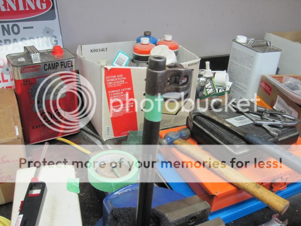

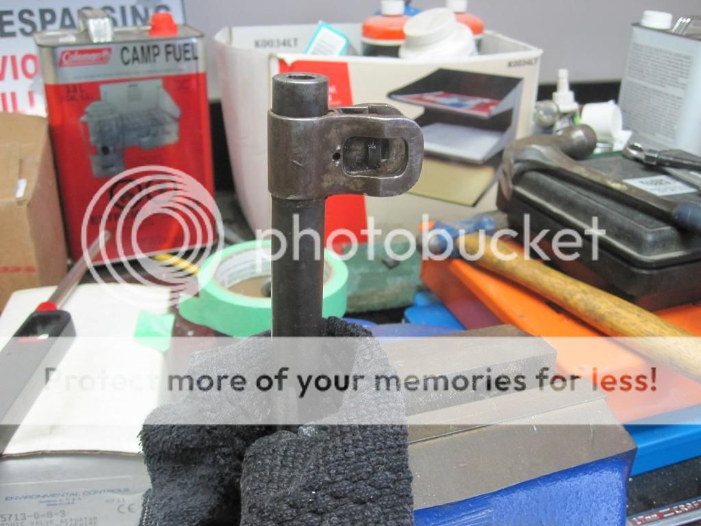

6) Pop the gizmo into the bore, make sure the 5/8" wrench is located properly, the sock is in place, the vise just tight enough so the barrel can slide up and down easily... then smack the little bastard smartly with a ball peen hammer. DON'T just whale away at her, either. Controlled hits, square with the screw head. Remember the sight base is hot as he11... or SHOULD be. Heat is your friend... if you heat the sight base only, evenly, and not TOO much... like NOT red-frigging-hot, then you will NOT take the heat treat from your barell.
7) Once you have "cracked" the unholy bond between the barrel and the sight base, you will hear it and see it start to move... stop using the hammer.

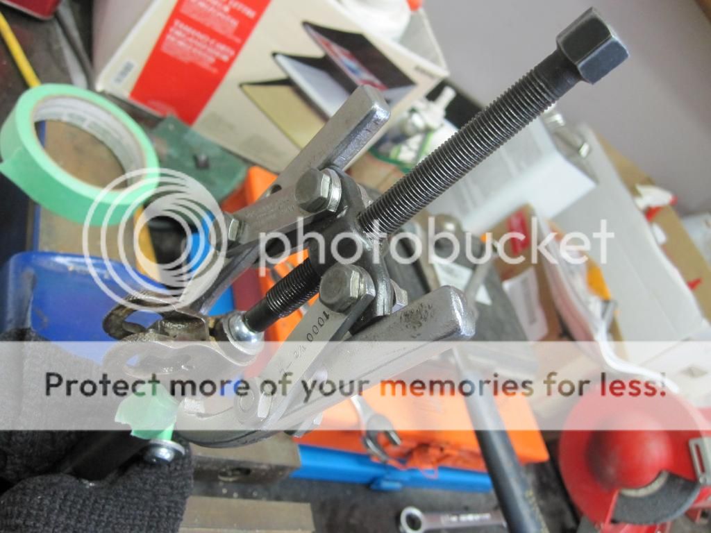

You can now remove the gizmo, and replace it with another plain Robertson screw with the threads taped up as before. The screw is big enough to not contact the rifling either.
8) NOW use your new puller, the square head will center the puller with the bore, the small purchase the jaws actually get on the sight base is not great, but quite good enough to....
9) Remove the sight base with hardly any effort at all, simple hand-torque with an adjustable wrench was all I needed, and finished with just my fingers. Oh yes... the sight base will be hot. Yes, still quite hot. Ask me how I know....
