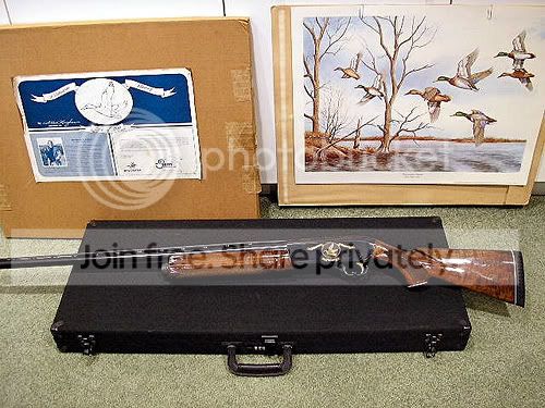

I'm no expert my friend just an guy like you that tossed my 1100 aside when the x1 came out in the mid 70's and loved it from day one. How could you not it was quality in every piece. My Dad and brothers were also shooters and bought some which I kept until 2-4 years ago when I decided I didnot need them all. There was 8 ?? I think in the locker with probally 6 extra barrels. A few sold at the club and I sold three here. My dad was a yank and would take them back and forth across the border when he was shooting which is how most had been touched by Bob Baumgardt for trigger work etc who was the true super x expert.
Some of the nicest wood in my opinion I have ever seen on a gun was fitted on some models. My favorite was the miss flyway special edition. Take care

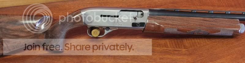

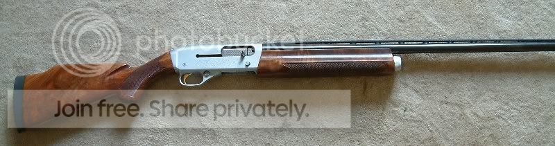

I have never had the opportunity to meet him but my Dad did on many occasion. He was a very special gunsmith that ran his shop based 100% on working on super x-1. He would do custom guns, and just about any trick work you can imagine a shotgun could require from special plating, hand made stock sets, porting you name it. He had a wicked web page with tons on write ups, pics, etc and sold every part you would ever need to keep your super x-1 working. Normally when you see a nickle plated receiver and/or fancy scrolled bolt it is a gun touched by Bob. Here is a nice write up on the x-1 and I will add a few pics of his work. My apologies to the OP for going off track a bit here but some good reading if you own a super x-1
