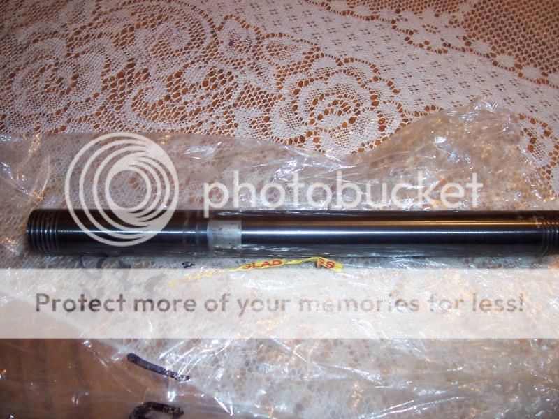

The thread length was driving me nuts so I had to go dig one out. Good new was the box of parts was right where I put it maybe 14 or 15 years ago since that would have been when I did the last one
On the original there is a one thread length difference 7 on one side and 6 on the other which with the heavy pitch could make a difference on installation which is probally why as you state Spank they use a defined depth for installation
God know's how today's replacements are threaded and this one was labeled as out of a 1st year field gun
I'm Ok now :) and time to take mama for her coffee and sorry for the poor pic but mama has the camera's and talent here not me with my vintage Kodak easy share
