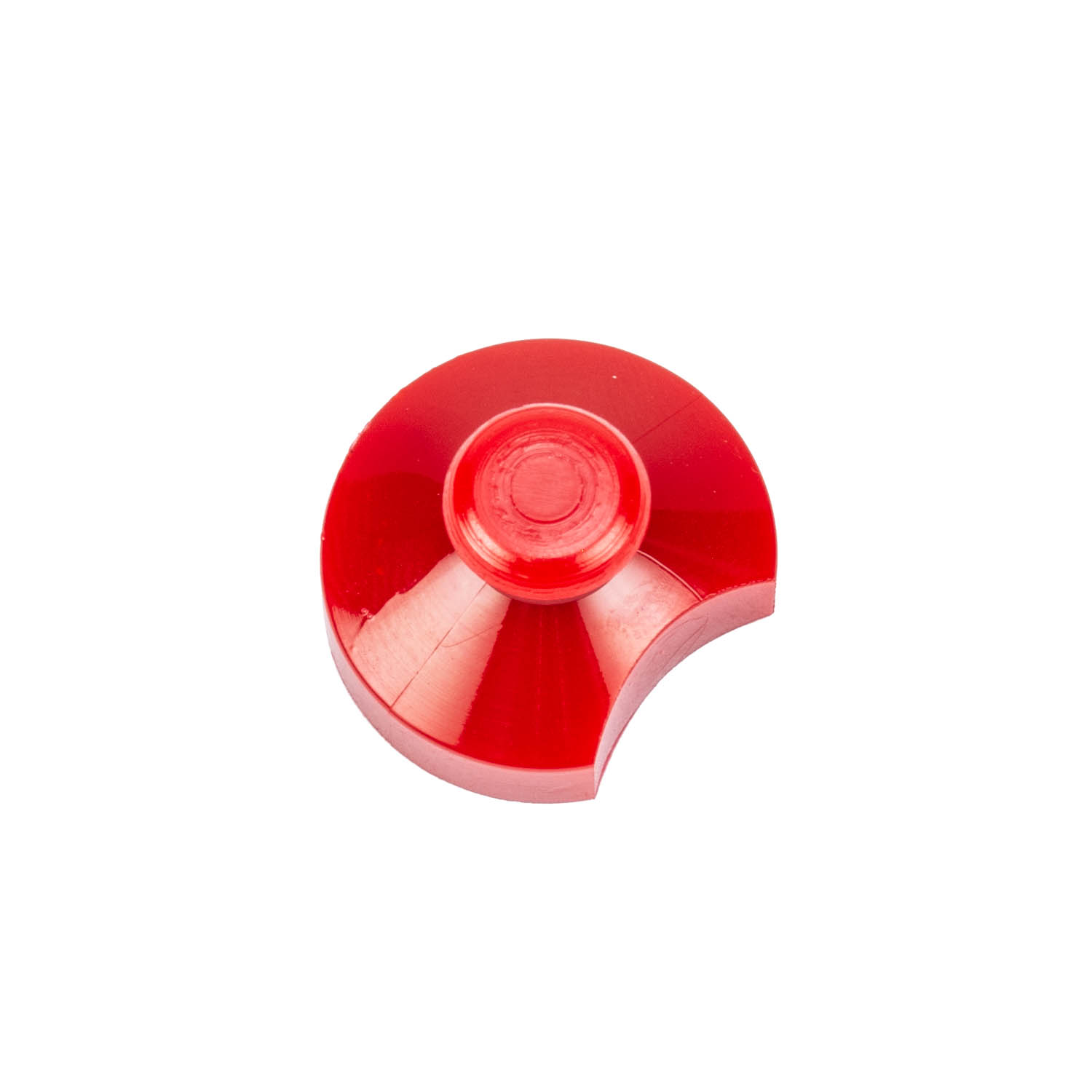

I recently inherited a late 70's Winchester Super X model 1. Would like to bring it out duck hunting this season but theres a few things needing fixed before then. So I'm hoping someone can recommend a good source for spare parts for the SX1, notably I wanna pick up a handful of buffers and oring which seem to be common wear parts.
You can order the parts from Numrich in the US. I ordered two buffers and two o-rings for my fathers SX1 without issue within the last 6 months.
I wouldn’t necessarily call them “common wear parts”, but these original polymer/plastic parts are now up to half a century old, and have aged to the point of being unusable. Modern replacements should last much longer.

My father and I both have Super-X1, both bought new...
Only thing that needed replacing were
- The buffers (both of them). Disintegrated, probably because the guns had sat unused in the back of the safe for the better part of a decade (kind of scary how fast time flies by)
- 1x o-ring, on my father's gun. He somehow damaged it while putting the gun back together... back then, we got a handful of them from the local hydraulic shop for $1... The extra were never needed have long been misplaced...
I see Midwest GunWork now offers one in "red"... Might be an option.

Is their shipping to canada reasonably priced?
Numrich has the red buffers for 24.57 each. I just ordered a rather bulky bit of parts from them including a butt stock shipping was 23.95. This is US funds we are talking here. You may have to pay some taxes to Canada Customs if they hit you. 99% of the time I have not had to pay any on orders from Numrich.
